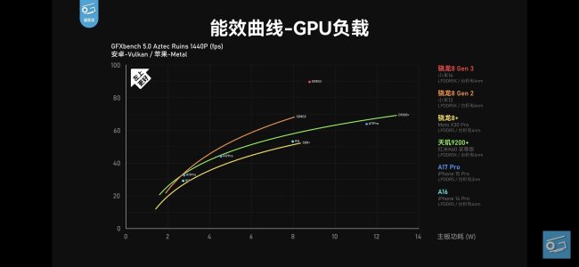

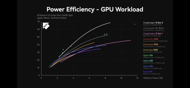

check this out.
Looks like the Snapdragon 8 gen 3 at 32 FPS has roughly 75% of the GPU performance of the Snapdragon X Elite.
Reactions: lightmanek
FlameTail
Dec 15, 2021
4,384
2,762
Oh and incidentally, it's faster than the best iGPU on PC: the Radeon 780M.
LOL.
I know it's only one benchmark, but still...
