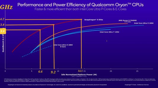

The power consumption of X Elite in ST is too high. 15W may be less than Intel/AMD, but it's not a huge enough difference. Apple M3 is not in this graph, but I assume it'll be like 10W.
It's fine - great actually - for a part that's on N4/N4P and given where AMD/Intel are. Absolute power consumption topping out at 14W for a 4.2GHz part including full platform vs AMD and Intel where they have a 20-30% lead on them in terms of performance - that gives them both a notable performance gain (or responsiveness) and around a 20-30% energy efficiency gain still at those same power consumptions. This is also their peak.
And sure M3 would be 8-10W, and more for the M3 Pro/Max likely. But it's on N3B and Apple is now just iterating year in year out off a base, so. This is QC's first part with custom cores and was saddled with internal drag and lawsuits. Qualcomm just has to consistently be much closer to Apple than the other two, this really isn't complicated.
X2 Elite should prioritise reducing this power consumption.
This is again just about the fundamental curves. They will likely improve the entire thing, but still keep something hitting 10-15W at peak, albeit with 25-40% more performance at that point. IOW, they will, but they're not going to take the power down to like 8W tops for a laptop part considering this is full platform. It doesn't mean the energy efficiency and slope of the curve won't improve.
I annotated the above graph by mapping the curve to frequency. It's not perfect though, because the curve is for platform power, not core power.
Still, we can see that the power has roughly doubled when going from 3.4 GHz to 4.2 GHz.
I agree with you, but you are looking at from a technological PoV. What about the market? Intel and AMD are debuting their next gen laptop parts (LNL and Strix) very soon. Those will close the gap with Qualcomm. If the gap is too small then, consumers will feel no reason to buy a Snapdragon X device.
Then tell me why is the the 4.2 GHz/4.0GHz Boost (10W+) limited to only the top two X Elite SKUs? Every other SKU has no boost and tops out at 3.4 GHz (~7W).
Unclear what you mean here. I said:
"This is again just about the fundamental curves. They will likely improve the entire thing, but still keep something hitting 10-15W at peak, albeit with 25-40% more performance at that point. IOW, they will, but they're not going to take the power down to like 8W tops for a laptop part considering this is full platform. It doesn't mean the energy efficiency and slope of the curve won't improve."
They'll keep those targets because they can without just getting sloppy with it. The whole curve will still improve in terms of power/performance.
You don't seem to actually understand why those SKUs exist. They exist because of binning and because Qualcomm decided they could push clocks some at acceptable power tradeoffs - the X Elite 78 and X Plus SKUs are lower quality and couldn't be pushed due to either inability or unacceptable leakage and power tradeoffs at those frequencies.
That's why I'm saying they'll do it again next time, albeit a node gain and IPC gains along with probably other cache changes will "push" the performance upwards at any given power, and also push the floor SKU clocks upwards. This is why I was mentioning what Apple could do since they don't really frequency bin.
So next time the entire curve will improve, and the base SKUs might be 3.8-4GHz with N3P, and permitting binning and timing constraints for the core, the new top SKUs might be at 4.4-4.6GHz.
The reason AMD/Intel stuff is higher clocked and can get fine bins still is less because of like core size and timing at this point (Lion Cove is still plenty wide and Zen 5 added some heft) and more because of the transistor choices, which impact the frequency you can hit and also the yields for those frequencies. See why Qualcomm's bottom SKUs are around 3.4GHz and similar for Apple on N4/5, whereas AMD can easily assure 4.8-5.2GHz on N4/N4P mobile parts.
But of course that stuff also consumes way more power anyways. Qualcomm is not going to do that. Think of what they do as opportunistic more than like deliberately trying to get crazy clocks, which is why it'll take N3E/P for them to get 3.8+GHz as the standard floor, because of their library and transistor choices. One thing that annoys me is the clowning about clocks from Armlets and then the counter mockery over M3/4 pushing them per se etc after people claimed Apple wouldnt do that blah blah.
Clocks aren't bad, it's good to ride out node gains, just without deliberately changing core designs and inflating the f out of area and power to chase more peak frequency within certain yields.
And to top that off, those top two X Elite SKUs are also extremely rare. The vast majority of Snapdragon "X Elite" laptops have the X1E-78-100.
Rare for now. 4GHz X Elite is in the XPS, Galaxy Book, Surface Laptop, so more likely just very SKU specific which is a good use of it.
But again this also goes back to what I was saying: these are bins. It could also be Qualcomm choosing to put more into the X1E-78 depending on demand too, but if you're saying "they're trying to keep power down", no, lol, if they could ship every SKU as the 4GHz one with that exact curve, they would, and they'd let OEM's lower the clocks if they so please. That power tradeoff from 3.4 to 4GHz is nothing like the BS AMD and Intel do where the slope is nearly flat from 10-25W and at a slow incline.
I understand why. The 4 GHz+ parts exist as flag carriers. They pushed the clocks to the limit of the silicon, as you can see in this power curve how the power shot up by 50% for 3.8 -> 4.2 GHz
Again it all hearken backs to the rumours, that X Elite was really supposed to launch in 2023 and compete with M2, but it got delayed for various reasons. Qualcomm had to pull several tricks, such as 4.3 GHz boost and running it in Linux, to match the M3 in GB6 ST.
They really need to reduce the ST clock difference between the topmost and bottom-most SKUs. 3.4 GHz -> 4.2 GHz is a substantial 23% difference. This kind of difference is never seen in Intel/AMD/Apple parts.
Speed demons (x86 cores) vs Wide Monsters (ARM cores).

They’re also binning P cores with that now, in a horizontal sense, but Qualcomm does that already anyways in addition to the vertical frequency binning. Either way, be it due to Apple’s tools and layout in combination (they’ve recently had notably higher clocks than Cortex Arm competitors and this has even increased in the last few years) yields, if 4.4GHz on mass parts with N3E is possible for Apple and at a power point that Qualcomm already has no issue taking with N4P, then I think we could see substantial clocks gains throughout the range with X2 on N3P. You wouldn’t get as much power savings at these peaks, but it’s still lower than AMD/Intel do at the platform level.
I think that base SKUs for X2 will be running 4GHz, with 4.2-4.6GHz models becoming much more common.
Assuming a 25% IPC gain and going through some N3P boosts to clocks across the SKUs (and also knowing the core structure itself already allows them to hit up to 4.4GHz at at technical level).
Doing the math, a 4GHz (about 17%) clock gain over 3.4GHz for the base X2 parts would have them at 3566 GB6 ST.
For the existing 4GHz part going to 4.4GHz, you'd be at like 3850 GB6 ST.
And for 4.2GHz, if they went to 4.6GHz for almost a 10% gain and they could get about a 4038 GB6 ST (again adjusted from their existing score at that frequency).
The 5GHz rumor I doubt they've made enough changes to allow them to hit that frequency without blowing power too far, but I can see a 4.4-4.6GHz top SKU setup on N3P. Maybe it is true though, and in that case: 4389 GB6 ST.
Regardless though it'd be an absurdly competitive part assuming the top power didn't change much and this is just pushing curve up which seems likely.
Too much could happen again, I don't have hopes up, but given GWIII's comment and the circumstances it's believable their next part would be this good.

Major IPC increase doesn't come free, without a power increase.
That depends on what you do, though. And it also depends on what goes on with cache and physical design changes. You're right, but you're just missing that the process gain for the frequency iso-architecture isn't the only change that will occur in tandem to + IPC and + some extra power. If the added IPC took power up 10-15% for the core throughout the whole frequency curve before node changes, but extra L2 and SLC took data movement down, they could be just fine. I know what you're thinking here and I don't disagree but it just depends.
If you are using the entirety of the node gains to increase the frequency, then you have no more node gains left to cover for the power increase brought by widening the core.
You are assuming the node changes are the only form power reductions can come in. Even with Nuvia I bet they have some phydes tweaks and core cache changes. For ex: Apple with the A16 took frequency up by another 10% despite moving from N5P to N4, but with 33% more L2 and some other tweaks they brought core power (iso-performance) down by 20% per their own presentation, and in practice after that and admittedly LPDDR5 (which tbf I think helped for the platform power) they got GB5 scores up at around the same power.
This is why my opinion is that Qualcomm should should not jack up the clock speed for Oryon V2, but do a clock regression + major IPC improvement. This way, they can deliver a major performance uplift without increasing the power envelope from 15W ST (or maybe even reduce it).
Yep ;)
Reactions: FlameTail

Also X2 Elite will have to do a minimum of 4000 points in GB6 ST (That is, matching/slightly exceeding the ST of Apple M4. M5 is another discussion...). That would be enough to place then ahead of Strix Point successor (Zen6) and Panther Lake.
