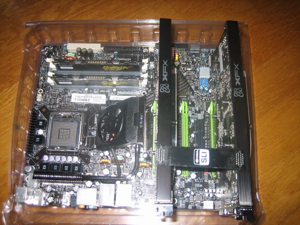

I have Sammy for Backup Purpose:
Sammy Spoiler:
http://i125.photobucket.com/al...aigomorla/IMG_1079.jpg
http://i125.photobucket.com/al...aigomorla/IMG_1081.jpg
http://i125.photobucket.com/al...aigomorla/IMG_1082.jpg
http://i125.photobucket.com/al...aigomorla/IMG_1083.jpg
