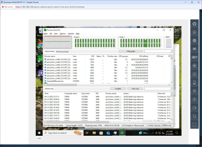

Well, since I am using simple settings, here is the Turin lasso screen. No SMT (simulated by lasso) and as I said the average time is somewhere close to or less than I posted before. We will see how things are going in about 3 more hours.

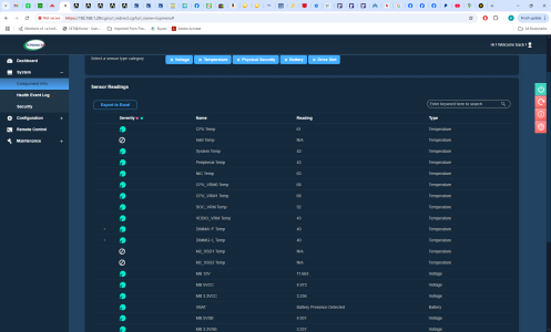

Bad news is, its 35F outside, and with the AC on, and almost nothing else running (F@H will be very bad for me this week) and the AC is running and its 79F inside. I can't stand it much cooler. God help my electric bill this week. and most of the windows are open too, to assist in cooling ! and same ghz as yours ~3.5 ghz, except the Turin runs 2.1. Thats with an AIO and a fan cooling the VRMs to 70c, cpus at 60c. Without the fan, vrms were pegged at 100c !!!
Lastly, That picture is of remote control using supermicro software.
The topmost CPU utilization graph looks good insofar that all physical cores are running one software thread each.
The process list below this is looking both good…
  • The CPU sets should follow the formula
    [ (0;2;4;6;8;10;12;14) + {0 or 16 or 32 or 48 or 64 or 80 or 96 or 112} ].
    Only then each of these eight CPU sets would correspond to one CCX exactly. At least that's according to what I understood how Windows is numbering the logical CPUs. The CPU affinity lists which your screenshot is showing are indeed following this formula.
…and bad at the same time:
  • The CPU sets to which PRST processes are bound each occur twice. Best would be if each PRST process had an individual CPU set which differs from all others.
It seems like Process Lasso is doing the desired job only partially. Edit: Or Process Lasso has got some sort of UI bug in which it displays CPU affinities of the 1st NUMA node only, not of the second NUMA node. After all, the topmost CPU utilization graph clearly shows that both NUMA nodes are loaded.
One step which *may* (perhaps) help with that would be to reboot into BIOS, go to "Advanced" --> "ACPI Settings" --> set "ACPI SRAT L3 Cache As NUMA Domain" to "Enabled", and boot back into Windows. After that, the bottom line of Process Lasso should say 8 NUMA nodes instead of the current 2 NUMA nodes. Each CCX will be a NUMA node then. And I hope that the NUMA node boundaries directly translate to process scheduling boundaries. (On Linux, the latter would be true by default without extra tools. As soft boundaries though, not as hard boundaries; but the overall performance effect would be close to as if they were hard boundaries.)
