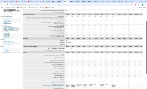

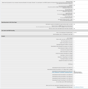

If you could post some screenshots from the Primegrid preferences website we might be able to notice something that needs changed. Also if you look in the log (messages tab in Boinctasks) it may something like 'not requesting cpu tasks for ____ reason'. This is how mine are set currently on the Primegrid website -
Thats it, The 8 and 1 are for the 12 different instanes on the 9654. It works good, as the 13th does CPU. Nothing uses school, work or Sun.

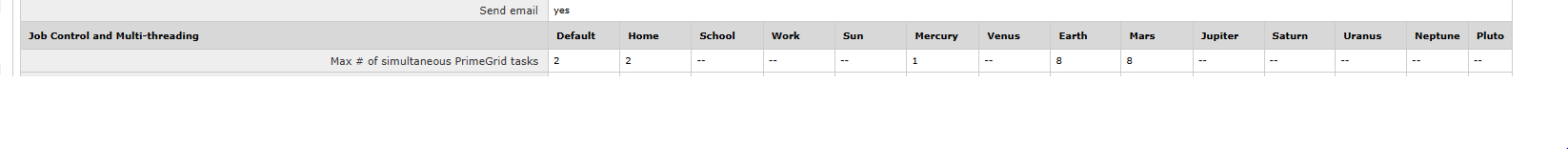

It's set to only run a max of 2 primegrid tasks for default and home, and 1 for mercury. It will only have that number of tasks total, regardless of whether they're CPU or GPU. You'll also see better points per day if you're running 2 or 4 cores (physical cores, not SMT) vs running 8 on these tasks. But your main issue is that you have the max # of simultaneous tasks set too low. I have mine set to unlimited.
You need to change this part here - View attachment 120589
Thanks. I restricted total tasks to simulate SMT off, and lasso did the rest. But adding CPU just hosed everything. I changed it, and will see after I get past the 2C tasks.
