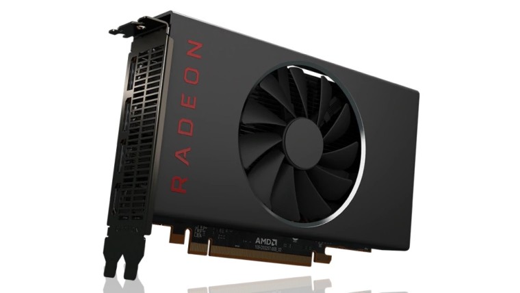

PCGH is the source of the benchmarks but since it's not in english, I'm linking a write-up on the findings as well.
This story popped up in my feed, not too sure what to think of it yet and don't have much free time to really dig into it but very interesting if true. Possibly could be a driver issue at work? I don't know, it seems like PCIe3 8x shouldn't be this restricting but maybe it is.
Shivansps
Sep 11, 2013
3,918
1,570
AMD did not cheap out anything, these RX5500XT are actually RX460/RX560 replacements, that also had a x8 PCI-E link.
What is actually wrong is that AMD attempts to sell these as a RX580 replacement.
They also forcebly removed PCI-E 4.0 support from non x570 boards and has been half a year with no replacements in sight. So... you want to fuly use a RX5500XT 4GB? buy a x570.
