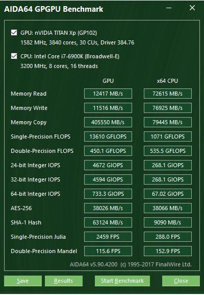

Do you happen to know where the tools that some reviewers use for bandwidth tests and such are on those forums? I've looked in the past and couldn't find them
Bandwidth tests? You mean GPU bandwidth or CPU bandwidth?
