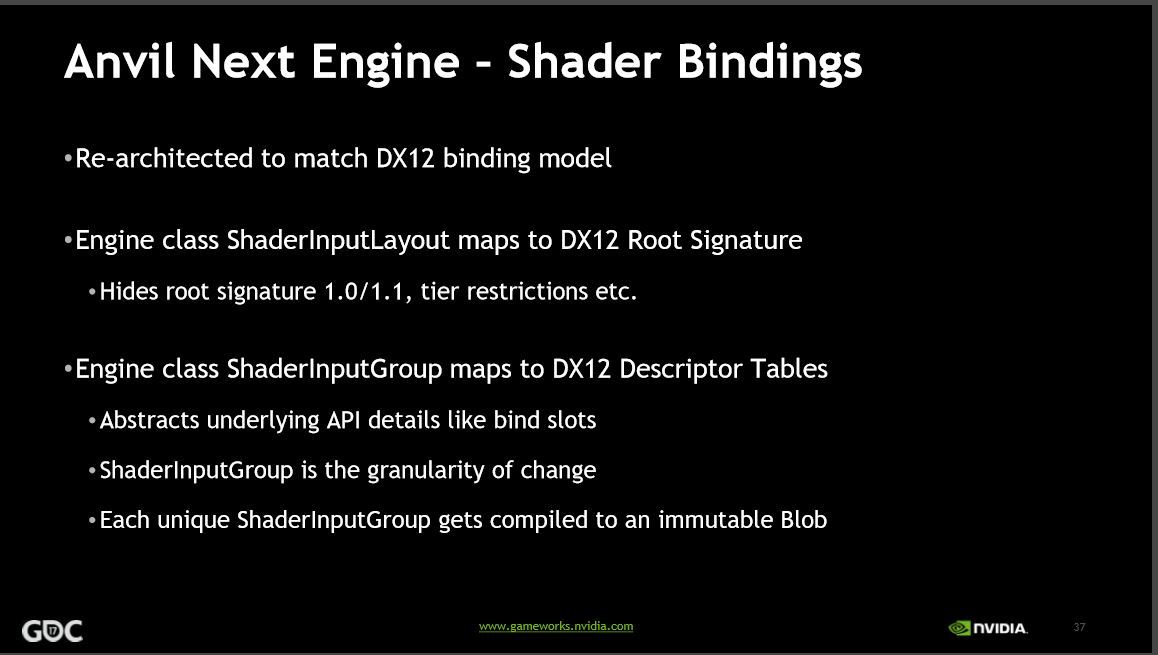

VLIW AMD GPUs (Terascale) never meant to have WDDM 2.x drivers, never they were advertised to be supported: they lacked of different binding features, like indexable resources, moreover the low-level binding model would be quite impossible to apply on those architecture. By some binding point of views Fermi was even more advanced then Kepler, unfortunately that architecture had other limitations in the chosen binding model (some of them in common with Haswell). If you think that 3 binding tier is a mess, the initial proposal was for 5 binding tiers and 5 coupling tiers.
It should be noted that Fermi does not have support for bindless resources and this shows in their OpenGL drivers too as they lack support for the extension. If Apple had decided to write Metal 2 drivers for Fermi it would most likely only support Argument Buffer Tier 1 since the maximum amount of resources that you can bind is 128 textures and 16 samplers which coincidentally matches the limits of D3D12 Resource Binding Tier 1 ...
The difference between DX11 and DX12 resource binding is the capability to do GPU side resource binding (bindless). In DX11, Microsoft had to account for the fact that older hardware didn't have the capability to do pointer indexing to the resources directly and instead had these special purpose registers or 'slots' one would call them for the purpose of CPUs to do these pointer bindings for the GPU resources. This is one of the reasons why texture state changes in the pipeline is expensive and that is one of the intentions that bindless strives to solve ...
With D3D12 Resource Binding Tier 2+ and Metal 2 Argument Buffer Tier 2 it changes everything about the way we do resource binding by exposing the GPUs ability to do pointer indexing into the resources ...
With Resource Binding Tier 1 and Argument Buffer Tier 1, you're stuck with CPU side binding ... (Yuck!)
On a side note with Terascale microarchitectures issue's with recent DX11 games there are a multitude of factors to take into account such possible changes to the conformance tests to account for the fact that the D3D11 spec has changed and that the drivers weren't updated with this in mind during the time AMD dropped support for their older microarchitectures. (Don't know how that would be possible since Terascale 2 & 3 cleared support for WDDM 1.3.) App logic can affect the way the driver behaves depending on how far the app is pushing the limits of the spec and that could be a probable cause. Another one that ties into driver behaviour is when the app is straight up violating the spec and that some drivers will play along with it while on other systems it could crash driver or fail to boot up and in this case the app writers is in the wrong for writing incorrect code and that AMD doesn't owe them anything since they've passed as a conformant DX11 driver implementation ...
So how does this help gaming? Does it actually increase performance, and if so, by how much? Or does it just take the CPU out of the equation, thus reducing power usage?

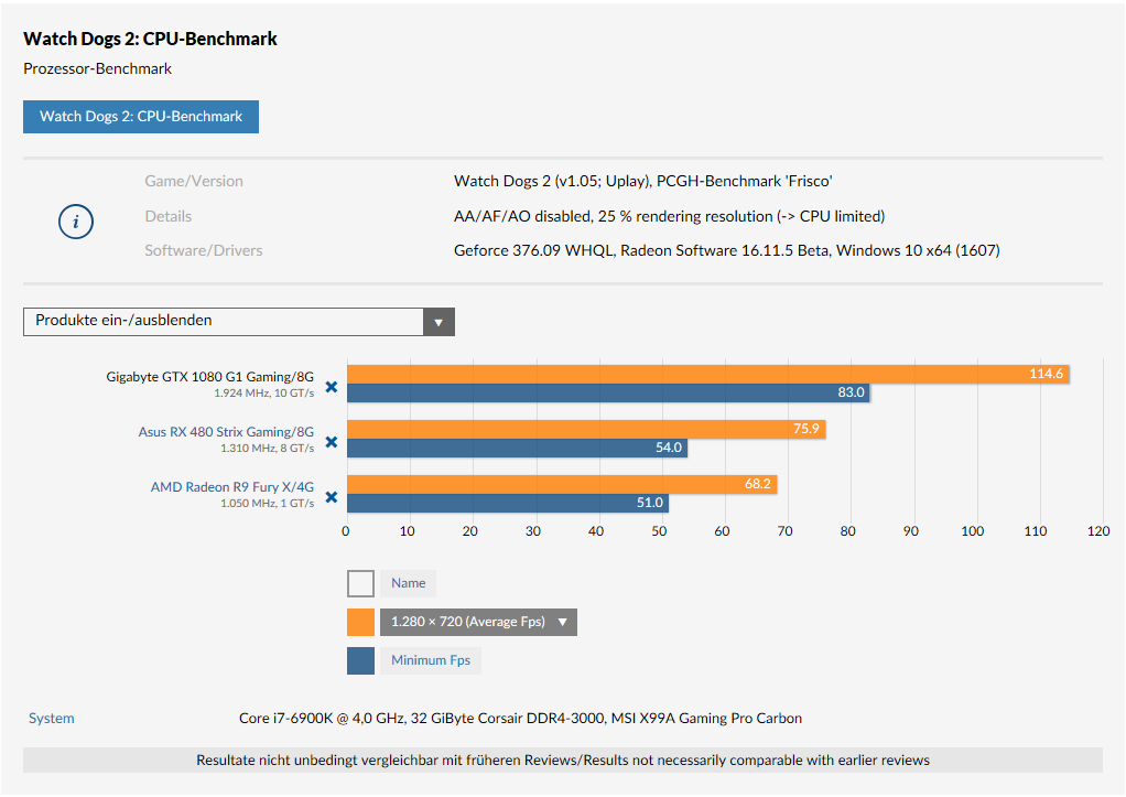

Driver overhead is real. I get your point about not knowing what is due to drivers, and what is due to the game's inherent multithreading capabilities, but when you compare AMD and NVidia in highly threaded games like the original Watch Dogs and Watch Dogs 2, you definitely see a pattern. Observe:
The original Watch Dogs:
NVidia's drivers are able to extract performance from HT, whereas AMD's is not.
Now Watch Dogs 2:
AMD is definitely CPU bound in this game, as there is a HUGE deficit between the GTX 1080 and the AMD cards at this CPU limited resolution. Such a difference cannot be explained by the game's inherent multithreading. Obviously the driver is doing some work as well. How NVidia does it, is not understood, but they've possibly found a way to add worker threads beyond the game's threading model to increase rendering output by using their driver.
That's why I say that NVidia can mimic the functions of DX12 with their DX11 driver. With DX12, adding concurrent rendering threads is basically trivial compared to doing so in DX11, where there is much higher CPU overhead and increased probability of threads clashing. That's why DX11 games typically are limited to one or two rendering threads. I'm sure that whatever NVidia is doing in their DX11 driver is a closely guarded secret, because it has allowed them to gain a notable edge over AMD throughout the DX11 era.
It's a combination of these things ... :)
The functionality is a lot more interesting than the performance or CPU reduction overhead benefits ...
It's good for optimizing GPU based culling, deferred texturing, and ray tracing ...
Reactions: Carfax83
All this sounds good. I think I posted this before, but Assassin's Creed Origins might be the very first game to use the DX12 binding model; at least for shaders. I don't know if this covers anything else like textures:
Now Watch Dogs 2:
The WD2 numbers clearly reflect the underutilization of the shader engines in Fiji, this isn't a driver issue, but an inherent limitation of GCN. You need to do more work to extract performance out of the extra 5 CUs per SE on Fiji compared to Hawaii. I bet that the R9 290X/390X would be in the same ballpark, perhaps even slightly ahead of Fiji. The same thing might be happening in Watch Dogs. So this may not be an issue due to threading. The usual underperformance of AMD GCN hardware on Ubisoft titles using AnvilNext is usually attributed to this. Plus as usual the high quantity of tessellation. This being a CPU-bound test, it is to be expected that the GPU utilization would be low anyway.
Also Polaris has better normalized geometry performance, tessellation and color compression, among other things - that's why it can outperform Fiji.
It may very well be true that AMD's drivers have limited multithreaded capability given how GCN works, but I believe that these results primarily reflect the underutilization of resources on GCN.
GCN truly shines when you have a game that is 50% geometry and 50% compute, which is why I'm looking forward to Sebbi's upcoming game Claybook, to see what it can do with GCN.
