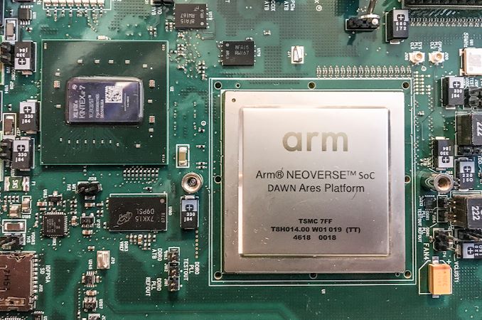

SMT performance gains will depend on how the CPU is design, SMT4 on Xeon Phi did provide impressive performance when compared to SMT Off.
There is a ARM Core that has SMT but I think it's a little core
