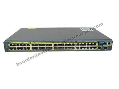

If one of those ports are working. I would highly suggest a switch, you can find enterprise switches on ebay pretty easily and cheap.
Here is one I found:

Thanks ! Thats $5 less than the 16 port I ordered, and I bet its a managed switch, thats all they use in enterprise.
I ordered one. I can return the Amazon one if this works. Free returns on prime. Right now most of my stuff is off of the 16 port switch. If I get that wireless access point, I can feed one cable to this switch and save a couple of those other access points.

Yeah doesn't hurt to shop around, especially if you know what you're looking for.
The listing I linked also has 1 year warranty which is surprising given these are used items and I expected a lot less(in terms of warranty, most do DOA and 30 days).
You might want to grab the serial cable given I think these switches come unconfigured and you'll need to do some configuration through serial
Although... I think it'll let you connect devices and they can all talk to each other. You just won't get VLANs etc etc without configuration
The cable is known as a Rollover cable, if you need to look for one

So, the input to the switch is the MGMT baseT in the very upper right ?

OK, very early results.... I plugged ONE computer into the switch, and to what I thought was the bad line under the house. Its working. I will work on the rest of the config tomorrow, too tired tonight.

OK, all computers are online now, but I still have to configure them for the new network (BOINCTASKS access) and nail the wires to the walls. I am unable to put them under the house now with my disabilities, and 2 doors will have to remain open forever so the wire can go through.
BUT, they are running. Step one ! I know its silly to use a 48 port router to feed a 16 port router and 2 more cables, but the cable length is a problem and it works, and I am tired.
$300 and 12 hours of work so far

I would say don't have the switch right against the wall, since they need air to cool itself down.
This is way to close to the wall, an inch would make the unit cooler + won't randomly shutdown to protect itself against thermal issues, since I think the fan is on that side

You can't really see it, but its like 6 inches out.
