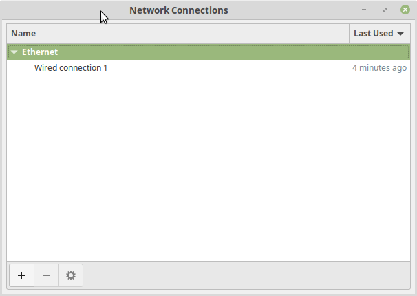

Edit: Either way you go, your Linux computer just sees a standard Ethernet connection.
