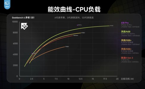

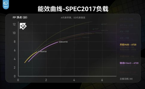

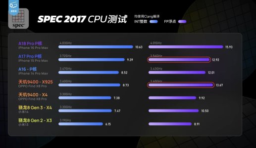

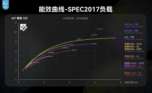

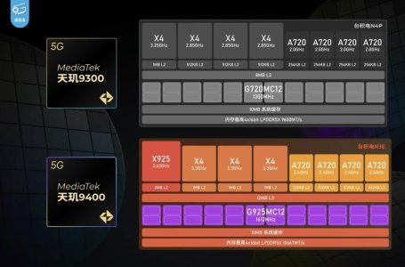

Important screenshot from Geekerwan's Dimensity 9400 review;
D9300 vs D9400 architecture

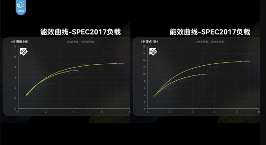

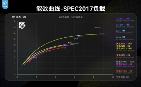

SPEC Scores and Power Curves;
Cortex X925 has a bigger uplift in FP than in INT.
Despite being the same A720 core uarch, Mediatek's D9400's A720 has improved efficiency, probably thanks much in part to the N3E process.

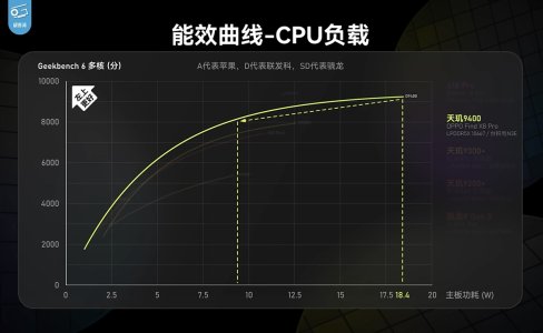

Geekbench 6 CPU Power Curve;

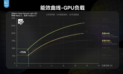

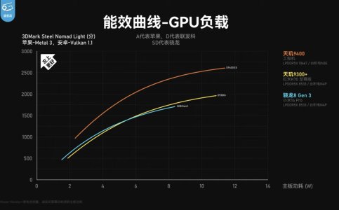

3DMark Steel Nomad Light GPU Power Curve;

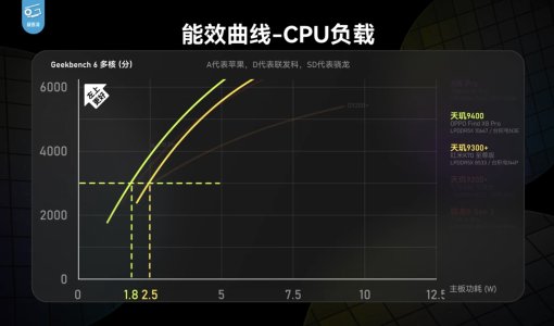

Dimensity 9400 brings huge improvements in the lower end of the power curve. This will be very meaningful for phones.

You can slash the D9400's power by half, and it still retains 90% of the performance. That means they doubled the power to get 10% more performance!
This kind of behaviour is common in desktop/laptop CPUs, where the cores are often pushed beyond 5 GHz.
But I am surprised to see such scaling in a smartphone chip, which maxes out at only 3.6 GHz.

The Mali GPU in the 9400 wasn't much changed in cluster count and has the same number of compute units as in the 9300 with more cache.
That's what makes the performance and performance-per-watt uplift of the Dimensity 9400's GPU all the more remarkable.
