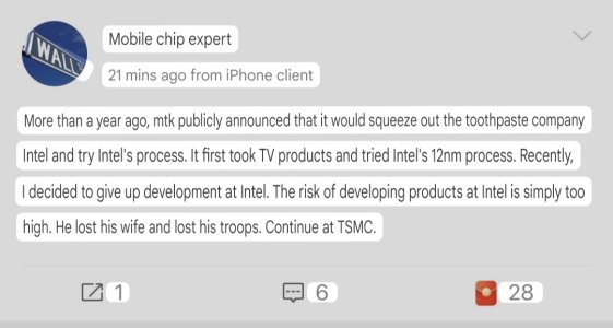

According to reports from leakers on the Chinese social media site Weibo, Mediatek and Nvidia are collaborating on a 3nm AI CPU. IT Home shared a report from user "Mobile Chip Expert" today, claiming that the CPU is entering the tape-out phase of production this month, with mass production on track for late 2025.

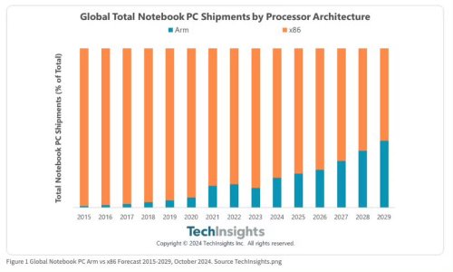

If that rumour is true, both Snapdragon X 2nd gen and Mediatek/Nvidia's SoC will be coming to notebooks in 2026. I don't think there'll be any significant growth in ARM notebook marketshare in 2025.

There will be no growth until there is enough optimised software.

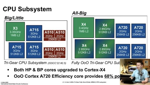

The 9400 is equipped with one Arm Cortex-X925 core with a peak frequency of 3.62GHz, three Cortex-X4 cores reaching up to 3.3GHz, and four Cortex-A720 cores with a maximum frequency of 2.4GHz.
I still haven't come around to accepting the fact that is reusing last year's microarchitectures for 7 out of the 8 CPU cores in the Dimensity 9400. Puzzling.

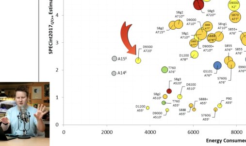

The A720s were reworked and has a different performance curve. I forgot which one, but one poster claimed the Geekerwan video showed virtually the same performance as Apple’s e core for virtually the same power in SPEC. I didn’t notice that and have been planning to rewatch it.
That would be an important accomplishment if it holds true.

Dimensity 9300 flagship chip introduced the first all OoO CPU design for Android phones. Dimensity 9400 is the 2nd generation and follows on the heels of it's predecessor.
The next step should be to bring the all OoO design to midrange SoCs.

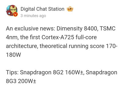

Rumour:
Dimensity 8400 will have 8 × A725 cores?

The maximum amount of L2 cache the Cortex A725 can be configured with is 1 MB.
Even Dimensity 9400 only has a total of 7 MB of L2 private caches across it's 8 cores.
