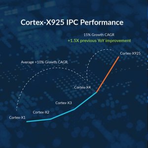

X925 does have a larger than usual IPC increase...
Yes Arm had to up the game, though it has to be seen how high X925 can be clocked in devices. IPC is not the whole story.
IMHO Arm upped the game starting with Apple first 64-bit chips which caught everyone by surprise. This can be seen for instance in David Huang perf per clock on SPEC for various Arm chips, many of which precedes Qualcomm chip. Just remember a CPU needs several years of development.

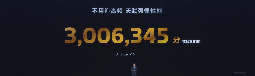

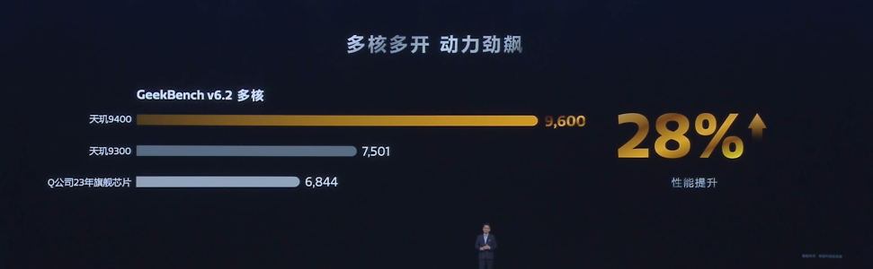

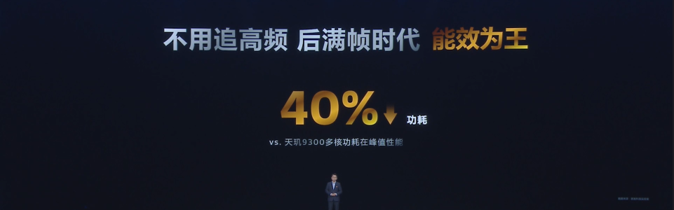

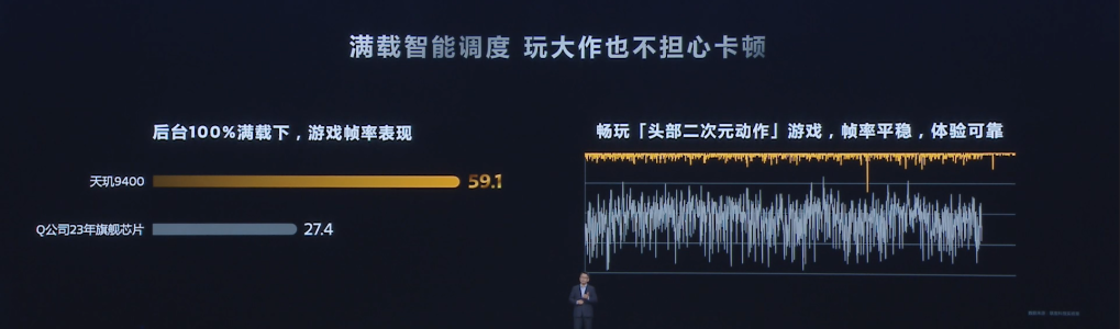

Here is the link to the presentation:
https://weibo.com/l/wblive/p/show/1022:2321325082930035950267
Here are some of the press material links:
https://corp.mediatek.com/news-even...-and-efficiency-for-the-latest-ai-experiences

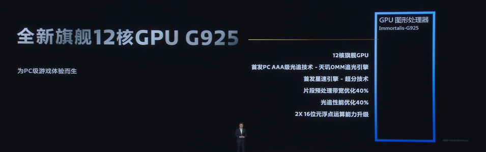

The Dimensity 9400 adopts MediaTek’s second-gen All Big Core design, integrating one Arm Cortex-X925 core operating over 3.62GHz, combined with 3x Cortex-X4 and 4x Cortex-A720 cores. This design offers 35% faster single-core performance and 28% faster multi-core performance compared to MediaTek’s previous generation flagship chipset, the Dimensity 9300. Built on TSMC’s second-generation 3nm process, the Dimensity 9400 is up to 40% more power-efficient than its predecessor, allowing users to enjoy longer battery life.
The 12-core Arm Immortalis-G925 delivers super immersive gaming experiences with up to 40% faster raytracing performance compared to the previous generation. The Dimensity 9400 also brings PC-level features to smartphones with opacity micromaps (OMM) support for realistic effects. The chipset’s powerful GPU also offers 41% peak performance boost with up to 44% power savings compared to the Dimensity 9300, allowing users to game for longer. Additionally, the Dimensity 9400 supports HyperEngine technology for super resolution and impressive picture quality, which is co-developed by MediaTek and Arm Accurate Super Resolution (Arm ASR).
Packing MediaTek’s 8th Generation NPU, the Dimensity 940feature0 boasts a number of industry firsts for exceptional generative AI performance; it is the first mobile chipset to offer on-device LoRA training, high-quality on-device video generation, and developer support for Agentic AI. To allow users to take advantage of the latest agentic and generative AI applications, the Dimensity 9400 offers up to 80% faster large language model (LLM) prompt performance while also being up to 35% more power efficient than the Dimensity 9300.
https://www.pcmag.com/news/mediatek...m-with-ai-enhanced-dimensity-9400-mobile-chip
https://www.androidpolice.com/mediatek-dimensity-9400/
https://www.androidcentral.com/phones/mediatek-announces-dimensity-9400-flagship-chip
https://www.androidauthority.com/mediatek-dimensity-9400-3488093/

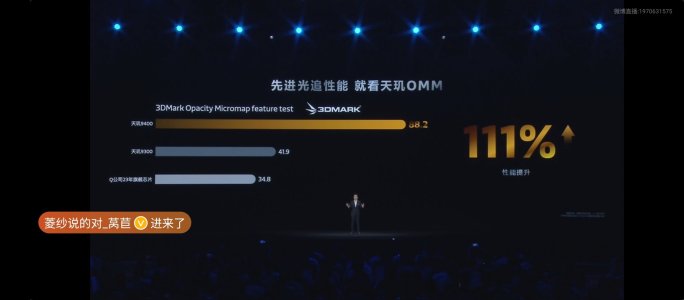

I took a bunch of screenshots, but there are too many to send. I've picked some of the most important to include.

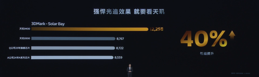

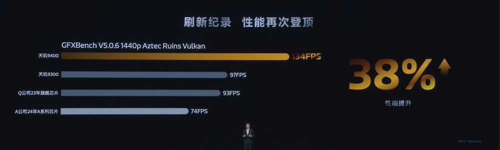

poke01
Mar 8, 2022
4,869
6,194
Interesting even with the beefed up GPU the Ray tracing is no match for M4 in solar bay.
M4 does around 14000 points in solar bay.
The only thing D400 GPU leads in vs M4 is GFX bench.
No 3Dmark WLE or SNL tests

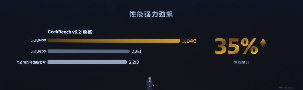

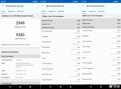

There is this video too which has some of the similar data (GB6.2 ST score is little higher in this example)L
I've been trying to find the briefing slides that are used, but as of now cannot.
The MT score of 9600, and really even the 3040-3055 ST score, seem quite high compared to anything in the GB database as of right now. Most show around the mid 2800s for ST, and 8800-8900 for MT.

FlameTail
Dec 15, 2021
4,384
2,762
Apple has a really good Ray-tracing implementation. I have heard it being described as a Level 3.5, similar to Nvidia/Intel, and far better than Adreno, Immortalis or RDNA atm.

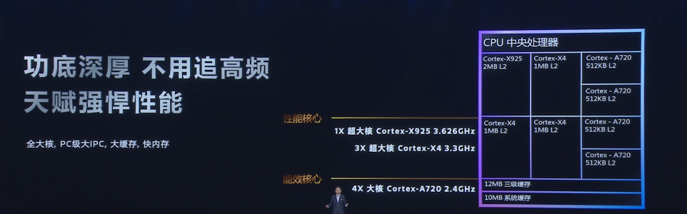

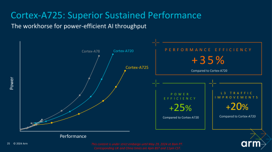

Interestingly, Mediatek has only upgraded the prime core in Dimensity 9400. The other cores are same as Dimensity 9300.
D9300
D9400
Cortex X4
1 MB L2​
Cortex X925
2 MB L2​
Cortex X4
512 MB L2​
Cortex X4
1 MB L2​
Cortex A720
256 KB L2​
Cortex A720
512 KB L2​
8 MB L3​
12 MB L3​
This is a rare situation. No SoC vendor is quick to using ARM's new Cortex A725 core.
Mediatek held off from upgrading to A725 in the Dimensity 9400.
Tensor G4 uses last year's cores anyway (X4/A720/A520). Tensor G5 might use A725, but that's not releasing until August/September of 2025.
Qualcomm has opted to use their Oryon cores in the soon to be revealed 8 Gen 4, so they are not implementing any of ARM'S new cores, including A725.
Samsung's Exynos 2500 might be using A725, but the rumour is that it's delayed. It won't be featured in the Galaxy S25 series which comes in early 2025, but only in the next Galaxy Z Flip/Z Fold, which is 2025H2.
Hauwei's recent Kirin SoCs have been using their custom Taishan cores, in place of Cortex X/Cortex A7xx. They only use Cortex A5xx as their little core.
jdubs03
Oct 1, 2013
1,496
1,079
D9300
D9400
Cortex X4
1 MB L2​
Cortex X925
2 MB L2​
Cortex X4
512 MB L2​
Cortex X4
1 MB L2​
Cortex A720
256 KB L2​
Cortex A720
512 KB L2​
8 MB L3​
12 MB L3​
They do upclock the X4 (15.8% higher) and A720s (20% higher).
Plus 2x the L2 cache. 1.5x the L3 cache.
(Adding core count/frequencies to your table)
D9300
D9400
1 x Cortex X4
3.25GHz
1 MB L2​
1 x Cortex X925
3.626GHz
2 MB L2​
3 x Cortex X4
2.85GHz
512 MB L2​
3 x Cortex X4
3.30GHz
1 MB L2​
4 x Cortex A720
2.00GHz
256 KB L2​
4 x Cortex A720
2.40GHz
512 KB L2​
8 MB L3​
12 MB L3​
I do also find it strange that they didn’t use the a A725. Perhaps it was a cost consideration? Doesn’t really make sense otherwise. Especially considering the increase in sustained performance.
(This graph is so obtuse btw.)
Reactions: Tlh97 and FlameTail

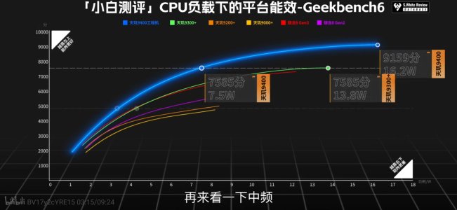

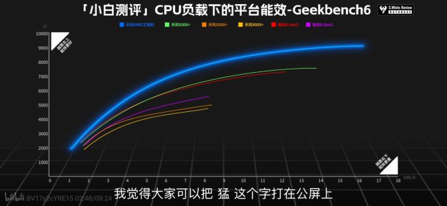

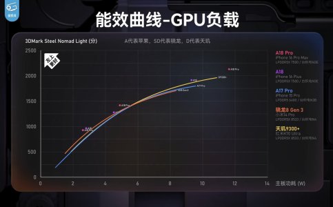

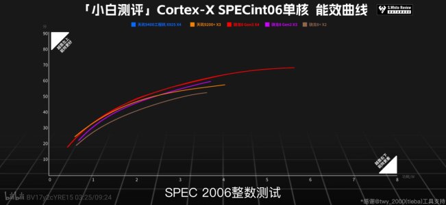

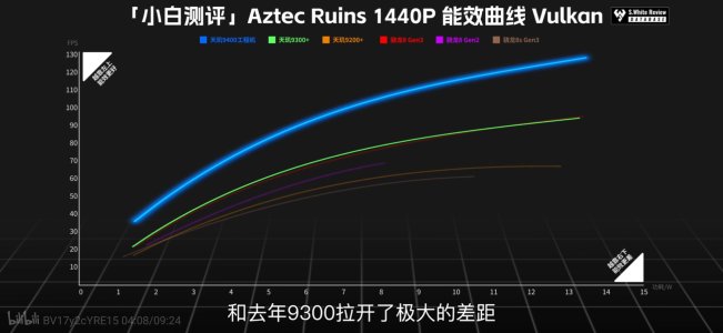

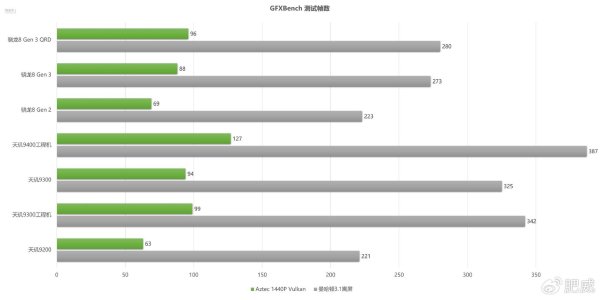

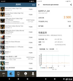

Some Chinese reviewera appear to have tested the Dimensity 9400;
View attachment 108986View attachment 108987View attachment 108988View attachment 108989View attachment 108990View attachment 108991
The quality is not very good; I'll personally wait for Geekerwan's review video.
But this caught my eye;
2500 points in Steel Nomad Light.
For comparison;
Okay now that GPU is impressive. Good job Mediatek and ARM. It’s peak in SNL is basically on par with M4.
Also the only reason why Mediatek is using an Nvidia GPU on PC next year is because Nvidia has much better drivers and of course mind share. The X925 CPU is awesome too.
mvprod123
Jun 22, 2024
547
593
For comparison;
CPU energy efficiency does not look very good. The A18 Pro wins here by a long shot. And in general, the new X925 core is not very impressive.
