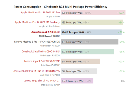

desrever
Nov 6, 2021
341
832
If you assume that TSMC N7 is ~ Intel 7,
Intel 7 is nowhere near TSMC N7 in perf/watt, look at how much intel got massacred in perf/watt on mobile side of things.
Alder lake vs Zen3 APUs isn't even a contest, AMD is almost double the perf/watt.
At this point, will Intel 4 even match N7 in perf/watt?
AMD's Chiplets using more power than monilithic die is the only reason Intel is even in the game in performance/watt on desktop.
For all that I said above, that's a terrible, meaningless comparison for different nodes. You have 4+8 vs 8+0, different architectures, different power limits, a single narrow workload, etc.
Its the best thats available unless you have access to someone fabbing the same chip on both.
Ofc there is architecture differences but both companies are optimizing for similar goals and the results is that. Intel's processors on Intel7 isn't even close to AMD's TSMS N7 parts in performance per watt in both client and server. Unless you think AMD is magically pulling so far ahead of intel on architecture, there has to be a significant difference in the process.
By the very methodology you used, you'd get radically different efficiencies between a 5600G and a 5800U, despite being the exact same silicon. That's just to highlight the problems with ignoring power limits and core counts, never mind the rest.
Binning matters ofc but its not the focus here, unless you think Intel bins their laptop chips to be higher power just because they want to?
5600G is very efficient as well if you want to compare to intel's desktop CPUs.
This isn't just binning. The same chip with a higher power limit will generally be less efficient at full load. Or the same power limit and less cores. I picked out these two specs just to illustrate where you'd start if you wanted to try to do such a comparison. Throw the architectural and design differences on top, and it's just useless for comparing nodes.
I'm being blunt but this is the other end of the continuum from H33x or whoever he is. Totally different architectures and different core counts as well. The closest we'd have is the I7 -> i4 Node data with the "Industry Standard Arm Core" but they did not in fact explicitly name that core. Even then it wouldn't be perfect if we didn't know the cache allotments etc, but that would be our best bet to comparing IFS to SS and TSMC. Sadly, again, we don't know what core that was.
