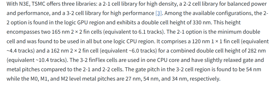

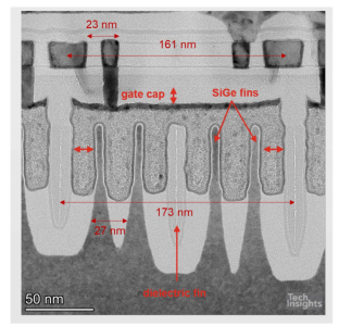

I believe it's actually 2-1
Techinsights for Mediatek 9400
Is 3nm really that much better than 18A?
I think N3P and 18A are going to be similar, like TSMC claims.
Should Intel switch over to TSMC after 2028?
If Intel thinks the gap between N2/P and 18AP is large enough that they have to go external for their high end dies, what would the gap be like in 28' with A16 vs just another 18A-P iteration?
511
Jul 12, 2024
5,424
4,843
Here are the core config and i think
  • 1x Arm Cortex-X925, 2MB L2 cache, up to 3.62 GHz 3-2 (needs it to hit high clocks apple also uses this for CPU)
  • 3x Arm Cortex-X4, 1MB L2 cache 2-2
  • 4x Arm Cortex-A720, 512KB L2 cache 2-1
