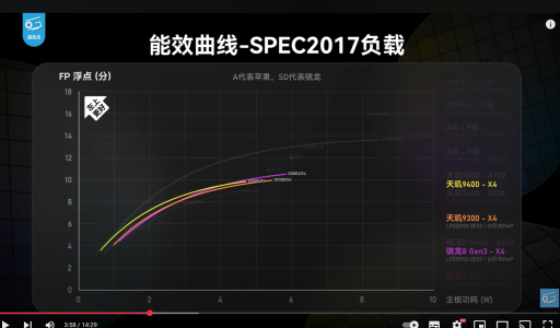

Idk if this has been discusses yet, but anyone check out the difference between the X4 on the mediatek 9300 vs the X4 on the mediatek 9400?
20-30% lower core area (both without the L2 cache arrays and with the L2), ~ same Fmax, and ~10-20% lower power on the low end of the curve.
The specFP curve actually shows even worse power numbers than the specint numbers...
