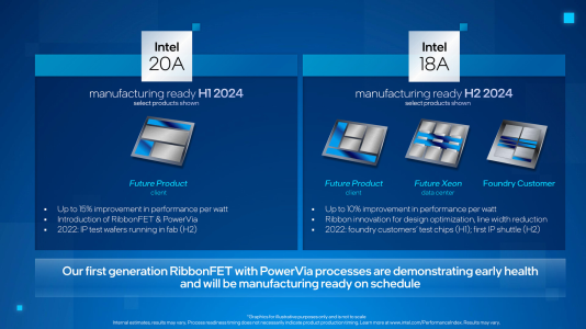

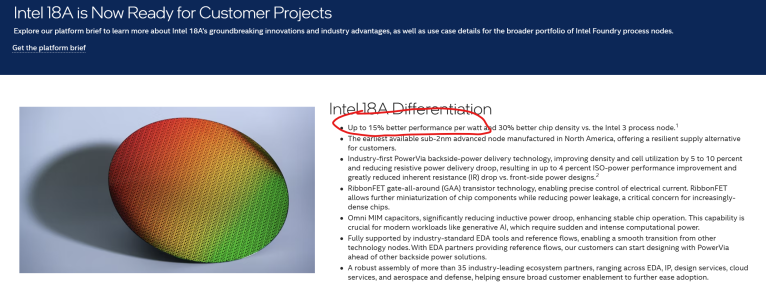

as for cut down performance take a look at their claims they said 10-15% PPW over I3 for 20A and 18A was 5-10% over 20A.
They said 20A would be a 15% perf/watt improvement, and 18A would be 10%.
This means 15%-26.5% PPW and last I checked 18% is between those numbers.
Intel only claims 15% for 18A. On the 18A website:

When taken together, from those slides it looks like 18A became 20A, and just kept the name.
Not really 20A would have been a minimalist node just like Intel 4 and 18A would be a superset to 20A like I3 was to I4.
