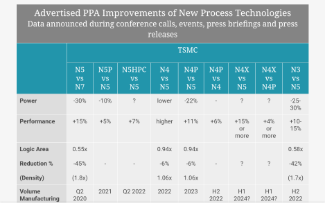

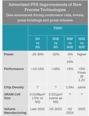

TSMC N5 to N3 is only 25% to 30% power reduction. How did you arrive at 47% PPW gain? I doubt it.
According to the Anandtech table, N3E has a 32% power reduction
