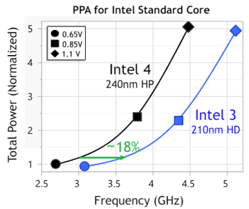

Geddagod
Dec 28, 2021
1,591
1,657
This tells us otherwise
What about this tells us otherwise?
Let's look at perf/watt at each frequency for the Intel 3 curve.
at 3 GHz, total power is ~1, so perf/power ratio is 3.
At 4 GHz, total power is ~1.5 (slightly higher actually), so the perf/power ratio is now 2.7.
At 5 GHz total power is now 4.5. Perf/power ratio is now almost 1.
The higher up you go on the curve, the worse perf/watt is.
Reactions: Tlh97 and Kepler_L2

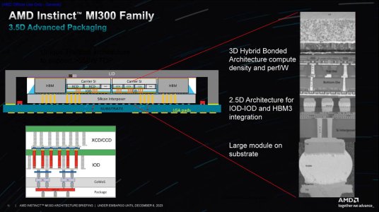

True. The terminology is not clear cut. But it is really stretching it to call 3D when a chip sits on top of interposer or passive base die
Pretty standard terminology:
2D = Chip-to-chip on substrate (e.g. Granite Ridge)
2.5D = Chip-to-chip on Passive Interposer or Bridge (e.g. Navi31)
3D = Chip-to-chip on Active Interposer (e.g MI300) or Chip-on-Chip (e.g Ryzen 3D V-Cache)
QuickyDuck
Nov 6, 2023
64
74
61
Well...
AMD says MI300 is 3.5D
