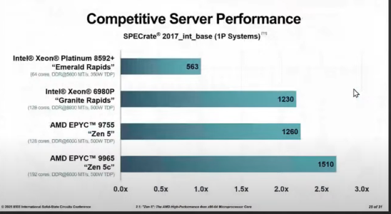

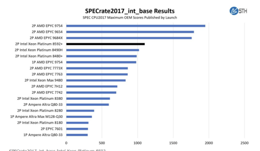

We thought GNR would improve competitiveness, but they don't seem to be hugely closer compared to Emerald Rapids. In hindsight, EMR did fairly well. Of course, lot of GNR's disappointment is due to puzzling lack of scaling.
I wouldn't be taking Phoronix's geomeans with much confidence.
AMD's own slides have GNR competing with at the very least, Turin Standard.
Meanwhile this was EMR vs Genoa:
GNR seems to suffer due to the per-core performance not being very competitive since it uses RWC vs AMD on Zen 5. That issue should also be fixed to an extent with DMR too.

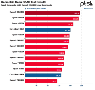

Current, LNC and Zen 5 have similar 1T perf.
I think that may be the case in "client productivity" applications.
But in server / workstation / desktop gaming, the gap is quite wide.
According to Phoronix, Arrow Lake trails 9950x by 18% and 9950x3d by 21%. Gaming is as much as 30%. Which is why I rounded to average 10% lead as a safe starting point.
You may get instances of LNC and Zen 5 having similar 1T performance, but that is with P cores that are too big and too hot. Which is what makes them a dead end (in eyes of Intel).
