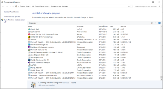

RE: an anecdote to Windows resiliency.
Believe it or not, my 5900X box has been running the same Windows 7* install and just going with the in place Windows upgrades since Windows 8.
Started it on i7 920 -> i5 2500K -> i7 2700K -> i7 4790K -> Ryzen 9 3900X -> Ryzen 9 5900X
* because, looking back, Win7 to 8.1 Pro, which I did, did remove *most* programs, so I suppose it was more a semi-fresh install than an upgrade?
The switch to AMD from Intel was a matter of booting into safe mode and uninstalling all drivers, then booting with new board NOT connected to internet, installing chipset and all other drivers from fresh downloads off a USB drive.
I have migrated the primary SSD a few times using Macrium.
When bench-marking / stress testing the new stuff, have never had anomalies or performance regressions; the biggest annoyances were related to switching to a 2560x1440 monitor and higher end video card, and having to switch all game resolutions / settings from 1920x1080 :)
Attached is my oldest installed software, yes, it may not prove much, but I have winged it like this (but making backups first!) for the past 10+ years :)
