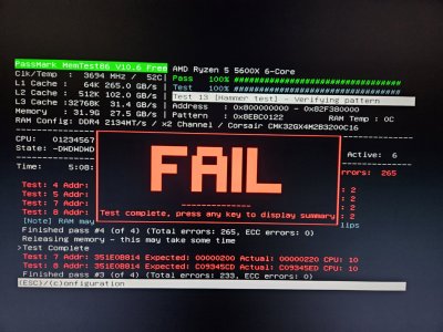

Time to rma? How can memory be this faulty?
Test# Tests PassedErrors
Test 0 [Address test, walking ones, 1 CPU]4/4 (100%)0
Test 1 [Address test, own address, 1 CPU]4/4 (100%)0
Test 2 [Address test, own address]4/4 (100%)0
Test 3 [Moving inversions, ones & zeroes]2/4 (50%)2
Test 4 [Moving inversions, 8-bit pattern]0/4 (0%)27
Test 5 [Moving inversions, random pattern]0/4 (0%)49
Test 6 [Block move, 64-byte blocks]4/4 (100%)0
Test 7 [Moving inversions, 32-bit pattern]0/4 (0%)182
Test 8 [Random number sequence]0/4 (0%)5
Test 9 [Modulo 20, ones & zeros]4/4 (100%)0
Test 10 [Bit fade test, 2 patterns, 1 CPU]4/4 (100%)0
Test 13 [Hammer test]4/4 (100%)0
Anything on a printed circuit board is made on a microscopic level. The chips are basically allowed to have chemistry do its work to turn into a functional product, but the process can't be "micromananged" because things are just too small.
Soldering is also probably automated, and maybe there's a bad connection or somehow too much heat affected one chip.
Looking at the descriptions, it's pretty clear you can't trust this RAM to keep data integrity. So, yes, RMA is pretty much a necessity.
Yep time to RMA unless you have another pair of ram or another board to test ram in, because memory errors can be the result of CPU / MEMORY SLOT / RAM.
But im pretty sure corsair will accept the RMA with that picture regardless.
If new ram shows same error, then you can bet your board or CPU is borked.

The picture shows 2134MT/s, which is different from MHz. The frequency should be 1066MHz, but at double data rate, that makes 2134 MT/s. I think I mentioned before, even if XMP/DOCP is enabled on that kit, (it could simply be at JEDEC standard or at an XMP of DDR4 2133, or even Memtest could be reading it wrong) corsair rates it for that frequency, as does any memory brand.
If a memory kit isn't stable at XMP, most cases that is still faulty RAM in my experience, even if it runs stable at JEDEC 2133. It could very well be stable at a lower setting, but not at XMP, and this is still cause for RMA, as it won't perform at rated RAM specs. Now there are other factors at play besides RAM, such as IMC and board, but Zen 3 has a pretty robust IMC compared to say, the first Ryzens.
EDIT: I double checked the picture from Memtest, looks like the part number indicates XMP is DDR4 3200 C16. If it is really running at only 2134, then it isn't even stable at JEDEC, let alone XMP.
Ahh your right i must of had a brain fart to read MT/s as MHz.
So yeah, he's running 1066mhz which is probably the lowest JEDEC.
