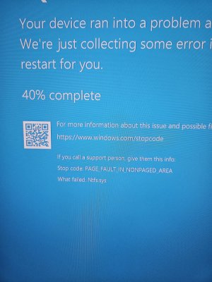

shabby
5,782
45
Just crashed now after almost finishing loading windows, i've had a few ssd's other than adata and the issue still persisted between all of them.

19,644
13,498
I used to have that error with Corsair RAM and it would happen with the PC idling or when browsing. Never changed the RAM on my Z77 mobo and accepted the crashes due to their infrequency. However, my Z97 mobo rejected that RAM vehemently and forced me to go with Kingston. Zero issues after that.

Ajay
Jan 8, 2001
16,094
8,109
Do you know how to use the Windows Event Viewer? The application and system logs may help narrow down the problem. Problems like this are typically due to misbehaving services or out of date drivers on the software side; bad memory or a corrupt NTFS drive on the hardware side. System crash files can help, but that is a bit of a PITA.

Torn Mind
Nov 25, 2012
11,878
2,712
RAM can be an issue. Obtain sticks on the qualified vendors list or equivalent. Your original system's instability is still unsatisfactory. I've had my H77 running almost 24/7 for ten years without a single crash except when bad RAM or bad pagefile media(an SSD from Ebay, Toshiba).
If using a USB stick, even that can be an issue because some sticks can hold files but have unusable sectors. It just happened to me a couple weeks back. A foul Team USB stick and a defective Inland 240G drive both presented issues. Windows and Linux installs failed on the bad SSD.
The stick(different from the one used to install on the Inland SSD) was an issue even with problem free BX500.
