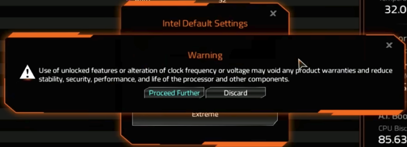

Cinebench is crashing for him because the new BIOS is applying the wrong milliohm value for AC load line and the VRM.
He is showing that the 1.55v limit can be easily bypassed and how the motherboard can be causing the workloads to crash when incorrectly configured.
He recommends setting a core voltage limit of 1.4v and I think that seems perfectly reasonable until newer BIOS versions are ironed out.
Yeah about Buildzoid I agree, but his issue was more the vendor bios and how it set their own preset... rest I am not sure if I can follow him where he do not like how intel have dozen of cpu voltage settings, hard to know if he has a point
