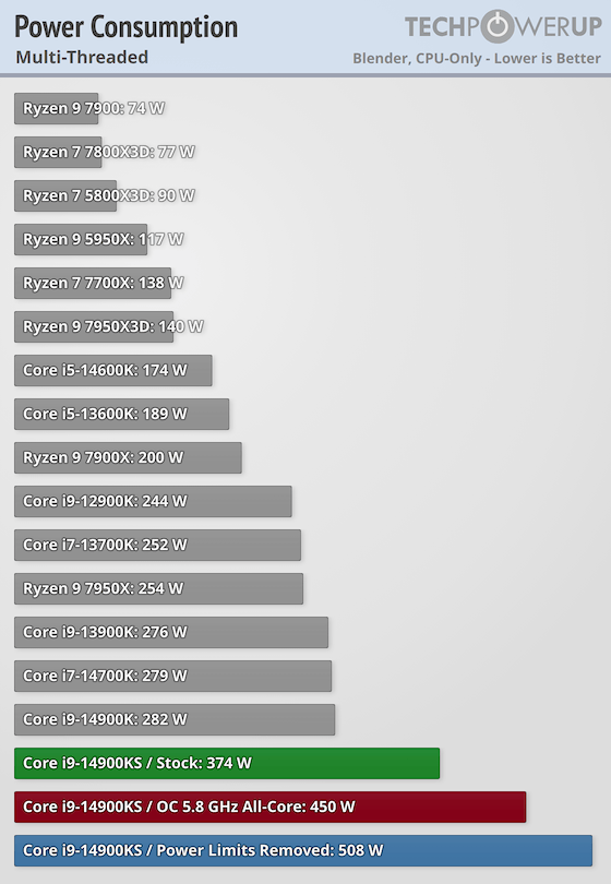

Stock 7800X3D faster overall in gaming than 14900KS even with power limits removed.
49W vs 188W in gaming, 3.8x power consumption of AMD. I guess those Cinebench E-cores really help with "gaming efficiency", amirite? It's no wonder Intel's new "gaming accelerator" utility disables them. o_O
508W in multi-threaded workloads with no power limit. Remember, that's what virtually every Intel enthusiast mobo does when you enable XMP.
Even at stock, "253W TDP" is nowhere to be found. Again, I wonder why Intel still isn't mandating reviewers lock PL1 / PL2 and disable XMP, despite Intel being aware their CPUs fail certain workloads. Hmmm, what could the reason be?

Unfortunately the power consumption numbers from the Techpowerup review tell the same story we've seen in this thread, the one that probably contributes to system instability issues in the OP. There are several benchmark runs where the "stock" 14900KS reaches 350W+ average power consumption on the Asus Z790 Maximus Hero. According to Intel, the maximum turbo power of 14900KS should be 253W. With peaks certainly going well over 370W, I think there's a high chance that stock ICC_max isn't enforced either.
I think there's plenty to discuss here still, as it appears neither Intel or mobo makers (in this case Asus) are taking steps to make stock behavior consistent with manufacturer specs.
