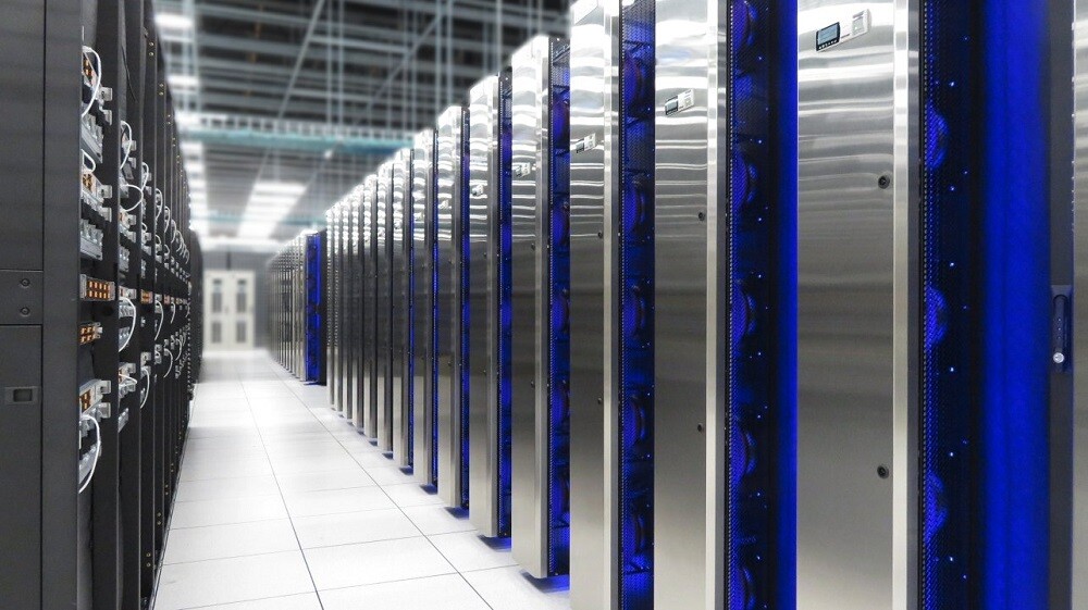

What I, personally, find distasteful, is the fact that one one hand we're beginning to realize that humanity needs to curb its energy consumption and carbon emissions, in order to slow down climate change, while at the same time greedy companies like Intel are wasting insane amounts of energy in their products, just to eke a few measly percentage gains over their AMD rivals.
"Don't worry" about it, currently AI companies are burning so much energy that some states in the US need to rethink their infrastructure strategy.
Whether DIY builds boost to 250W or 150W pales by comparison, and I write this from a 12700K with PL1=PL2=120W so I'm a firm believer in energy consumption with common sense.
