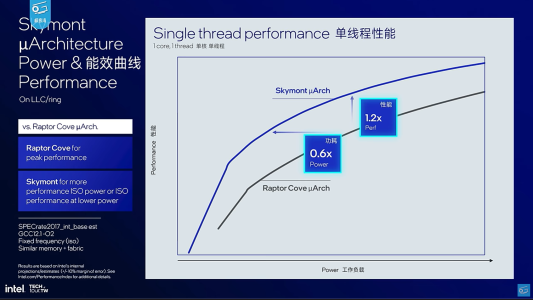

We missed one interesting slide from the presentation with a comparison between Conroemont and Raptor Cove on different power levels...
That looks insane!

With Skymont being roughly equal in IPC but on a much more efficient node, this isn't surprising. Raptor Cove would eventually take over in performance if the graph extended further, but it would obviously take a whole lot more power to get there.
Still, it's quite the leap from Gracemont/Crestmont. Gracemont ran too hot. Crestmont was clobbered by tile latency. I wonder what Skymont's Achilles heel will be.

For sure, the leap they made with Skymont is extremely impressive. I'm very interested in seeing the final clocks as well as we still don't have official confirmation on that, unless I missed it. For its purposes, I don't know if Skymont will have an Achilles' heel. Against Zen 5 it will have some "weaknesses" (e.g., lacking AVX-512) but I don't think that they will matter for its intended customers.
