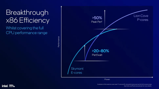

Yes, we have a slide covering the performance and power curves. I think Skymont will work great on lower power levels (1-5W per core), but Intel may decide to push it to 4-5GHz in the desktop Arrow Lake. Unfortunately, the right part of Skymont was not shown on the chart.

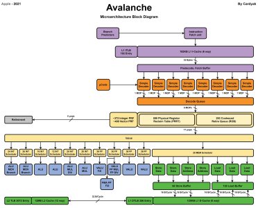

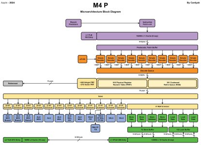

It may sound funny, but Conroemont (aka Skymont) is not that different from Apple Silicon P-cores in terms of internal structure. 9-wide decode, 8-wide allocation, 3 load units, 4 STA, 416 ROB...
Yes, it's not correct to compare CPUs this way, and a lot of details are simply missing, but still, it's not that different.
