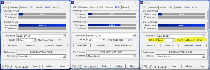

Intel Core Ultra 7 265K @ Kocicak CPU-Z 2.11.2 x64 (Version 17.01.64)
Paradigm shift: 12c .LITTLE Atom Skymont E-cores beats 8C big Lion Cove P-cores !​
source:
Thank you Kocicak alias BoggledBeagle on techpowerup forum.
LightningZ71
Mar 10, 2017
2,692
3,390
This is going to be HIGHLY dependent on cache residency. If whatever task you are running can live in 1MB of L2, then the Skymont chip should easily beat the P cores. If it spills over 1MB of L2, the Skymont cores will rapidly deteriorate in performance as they fight for L3 access on 4 way shared interfaces and suffer the very high L3 latency that Arrow Lake has.
What I would be interested in is a 2 P core + 24 e core design with two major changes: double the L2 to 8MB for the Skymont clusters and increase the L2 on the P cores to 4MB. That would hide the L3 cache even more and make the E cores more load agnostic.
