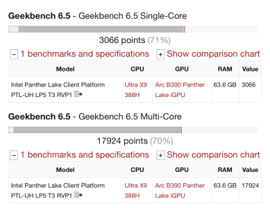

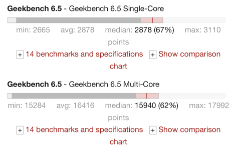

I know it’s just Geeekbench but:
Ultra 9 285H
Pts per clock (single core):
UX9 388H: 601
U9 285H: 533
That’s not terrible in terms of IPC.
There's nothing wrong with Geekbench. But it suffers from all user-submitted benchmark problems: lack of consistency. That's why sorting is a big deal, because you need to compare peak non-OC results using same OS, and then they are comparable. The peak scores are those free from OS, driver, configuration, and random fluke variations. That goes same with @poke01 GB results.

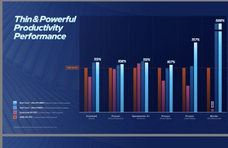

Sigh do they?
This one shows they regressed in ST
Hold on. Let's have a good look at this.
First of all I see Panther Lake beating the HX370 while using 8 Watts less. It's not huge, but well, there it is.
Second, we have to look at the core configuration for Panther and Arrow H.
4+8+4 for Panther and 6+8+2 for Arrow
Here's the thing. At Iso-Power P cores are always going to be more efficient than E cores.
Panther has traded 2 P's for LPE's and still comes out about even in 4 benchmarks and far ahead in another. Just talking CPU here.
Also, honestly the one where it dominates is the most important one, video editing, the one that gets you waiting the most.
So full power is going to be the toughest comparison for Panther to Arrow due to that 2P for 2LPE swap. But I would suspect battery life is going to be great because that LPE island might actually be quite able to keep the P's sleeping much of the time.
Now to play devil's advocate. If Intel has kept the core configuration the same for Panther, that being 6+8+2, Panther would have looked better and we would have gotten a better CPU.
But Intel is Intel and they saved quite a bit of die area by swapping those P's for E's. Even if the ratio is now 3:1, losing 2 P's give you enough area for 6 E's. They only need to add 2 E's, not 6, so they saved the die space of an entire Darkmont cluster!
To quote Newman from Seinfeld in Jurasic Park, "They got cheap on us."
