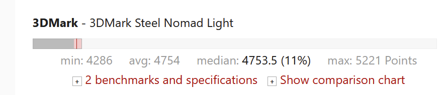

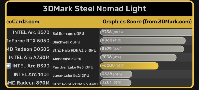

Probably results from a 45W configuration where it's nowhere near as efficient. Should be closer to 5k in Time Spy at 25W. Still nice to see the potential is there to scale up a fair amount when provided with more power.
511
Jul 12, 2024
5,017
4,528
i don't think it's 45W it's likely t be 40W imo
Magio
May 13, 2024
194
231
From Intel's slides when they (sort of) unveiled PTL, that's the big difference vs ARL/LNL, the GPU is not a million times more performant than those at low power but it scales far higher.
For my own preferences I do hope it does well enough at the sub 30W range that manufacturers ship decent thin and lights at that TDP, but the upside on slightly chunkier designs that can handle 40+W is good news too.
DavidC1
Dec 29, 2023
2,003
3,152
The iGPU Score is better than M5 but package power is unknown
Some of these benchmarks favor the mobile variants too much with FP16 vs FP32. The Aztec benchmark for example needs to add 30% for Intel/AMD GPUs versus ARM because of this. The only proper synthetic benchmark is Time Spy. It's not necessarily representative of gaming performance for iGPUs because it's too demanding, but can be if you play games that run at 20-30 fps.
