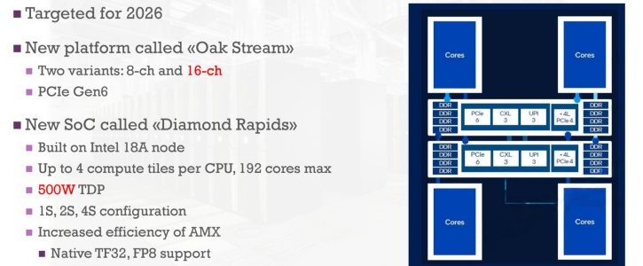

DMR tiles are rumored to be big, no? I expect each tile to easily be above 300mm2 each.
The real interesting part is that Venice is also rumored to be moving to bigger tiles on N2, or at least the dense variants of it.
Nope From my hypothesis DMR will reuse these tiles but swap out the core+L2 in favour Panther Cove for 16P core tiles each replacing 24E core tile.
So to make
For a maximum of 16*4 = 64 c per tile and than 4 Intel 3T base tile each containing 4 memChannel(not meme channel)
They can make
3*16*4 = 192C DMR SKU using 16ch
4*16*4 = 256C DMR SKU 16ch
3*16*2 = 96C SKU 8 Ch
4*16*2 = 128C SKU 8Ch
The format is 18AP tiles*Cores*base tiles on 3T
That's just my guess but it gives them quite flexibility and IP reuse between Clearwater Forest/DMR/RRF for the compute part the IO Tiles are Intel 4/3 though for DMR
So to make
They can make
2*16*4 = 96C SKU 8 Channel
I was going off this diagram
1755631520903.pngWhich Bionic said wasn't fully correct, sure, but then also said the core count was different (256 cores). I expect the tile config to be the same.
I also don't think DMR and CLF are the same "CPU family", for the tiles to be that interchangeable.
View attachment 128954Which Bionic said wasn't fully correct, sure, but then also said the core count was different (256 cores). I expect the tile config to be the same.
This DDR part is incorrect the Memory Channel are on Intel 3 base die not on IO die and the 4 Tiles are made of smaller 18AP tiles below them.

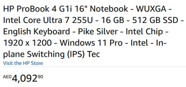

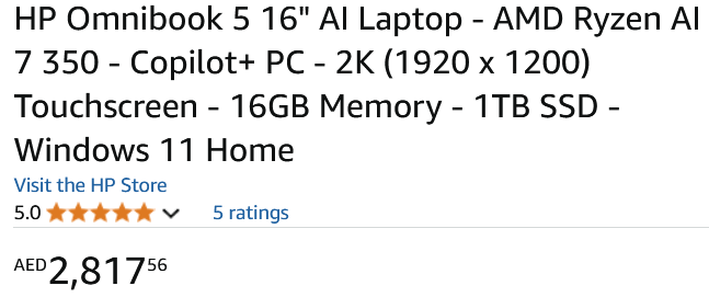

28,173
19,210
Oh the sadness of Intel being potentially-unable to make an Intel 3 stopgap desktop chip due to demand for Arrow Lake-U. Though to be honest, I have no idea how many units of Arrow Lake-U are actually moving out there.
Yes, I feel that sadness deep inside me too.
I can see few HP and Dell 265U and 255U models available on my local Amazon. All priced way too high compared to RPL-U so they won't sell much.
Only a numbskull would opt for the 255U laptop with such a massive price difference ($346).
Reactions: Joe NYC
Windows 11 Pro vs Home but -512GbB SSD for ARL-U vs Ryzen AI lol definitely not worth it
laptops costing >$1600AUD(~AED4000) should also have a minimum 1440p screen so text is sharp. 16:10 or 3:2 is good too but come on increase the res.
I'm not gonna say Intel's recent stuff isn't typically more expensive than AMD's, but this is comparing a ProBook (targeting enterprise) with an entry level Omnibook, they're not targeting the same segment at all. Here on Anandtech forums we look at specs first but the actual laptop market has a lot more differentiators than what CPU it runs on.
My general rule of thumb is that "enterprise" laptops support are always overpriced compared to their consumer counterparts, unless they come with enterprise level warranty and support.
28,173
19,210
My dumb IT guy would buy the overpriced enterprise laptop 10 times out of 10, not because the enterprise features are necessary but because Intel. If the prices and CPUs were reversed (cheaper Intel Omnibook and expensive Ryzen ProBook), he would get the Omnibook. There's a reason why I think of such people as absolute morons with just enough functioning neurons to fake it as fit for the job. Enterprise features matter only to companies buying lots of laptops in bulk for their workforce.
