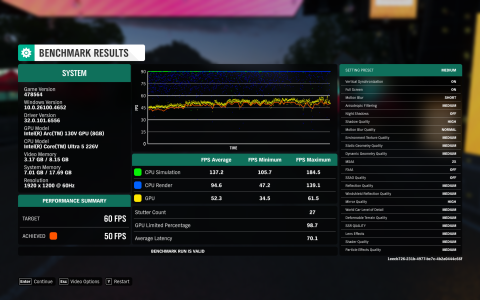

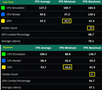

I finally found a game where Skymont was a bit better than Lion Cove even at ~28W.
Lion Cove:
Skymont:
But it's better by giving the GPU more power. The CPU render and simulation results are better on LNC, but it starved the GPU occasionally.

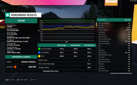

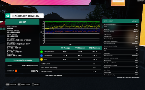

I do not think SMT is helpful here. It's basically showing that the power split is better for gaming with Skymont instead of Lion Cove
But at lower settings LNC pulls away because GPU performance is less of a limiting factor.
Lion Cove, lowest:
Skymont, lowest:
