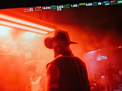

A screen cap where the CPU is at 800MHz may not be representative.
Every time I tried to limit games to e cores, the results got worse. On both the 226V and 265K. I really, really have to wonder what people are doing to get the contrary. It is seemingly impossible...
do you have an MSI device?
No, only an Asus laptop and a DIY desktop with LNC/Skymont to test. Plus I don't own that game. So I can't test this specific scenario. Maybe I can try to set the TDP lower, perhaps that's cause here.
Pirate it for science also windos affinity doesn't work?

I think the Lion Coves throttle easily, not necessarily because of heat but possibly due to some built-in protection mechanisms to avoid boosting them for prolonged periods. I think Intel got too cautious after the Raptor Lake debacle.

In LNL I think LNC doesn't have the power budget to be better than Skymont
