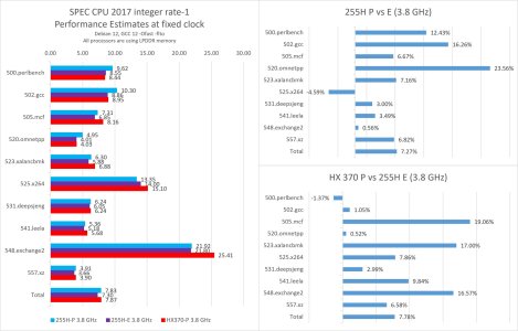

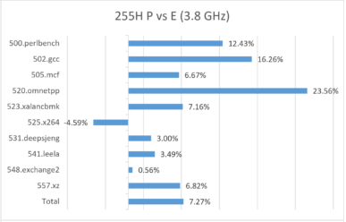

Why do the P core Exist sigh
1) As shown in the data you present, the P core averaged 7.5% faster.
2) But, the data you presented was ran with both the P core at 3.8 GHz and the E core at 3.8 GHz. The P core can go much faster than 3.8 GHz. The turbo P core speed is 5.1 GHz on the 255H and 5.4 GHz on the 285H. Meaning, the end result is another ~20% boost over the 7.5% faster shown in that data.

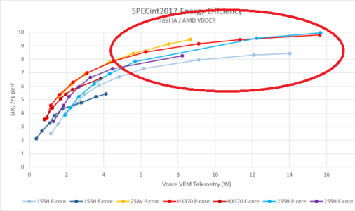

3) As @desrever stated, when running at high clocks, the P cores are more efficient, see the red circled portion of the graph below where the P cores (blue line) do more work at the same power as the E cores (purple line).
... and a voice of reason ;).
In engineering, "YOU NEVER GET SOMETHING FOR NOTHING".
Yes, E cores are quite competent at SPECINT2017 at low clock speeds compared to P cores, but just to point out the obvious....
  • Real applications are not SPECINT
  • Performance = IPC * Clock
  • Designing cores that clock higher costs more die space (for a few reasons)
  • Designing cores that clock higher makes them less energy efficient
I don't know if we can ever really put this discussion to bed with proof as it is difficult to divide the P and E cores out like that and run real applications on just one or the other.
From this graph the LNL P Core has better PPW than ARL-H so it seems that the Ring Bus/SOC Design is holding back the P cores but that may be true for E cores as well but my point is for power constrained devices P cores are not that useful outside of maybe like 4P Cores the additional 2P cores will steal too much from power budget.

From this graph the LNL P Core has better PPW than ARL-H so it seems that the Ring Bus/SOC Design is holding back the P cores but that may be true for E cores as well but my point is for power constrained devices P cores are not that useful outside of maybe like 4P Cores.
I have been guessing that the P cores can't be fed properly from the ring bus... at least in the latency department. Perhaps Panther Lake will show us what the P cores can do when freed up a little?
If you have a core that uses 10W on active but the SoC uses 5W, then the load TDP will end up being ~15W.
Since Lunarlake has a much lower SoC idle, it ends up lowering peak power by a bit too.
I assume Arrowlake is NOT the best implementation, but higher performance does increase cost, whether in money terms or power. Since Lunar came before Arrow, even though it was supposed to be the other way around, Lunarlake had far better execution, thus the teams were able to meet their goals, while Arrowlake probably failed in lots.
I think the decision to stay with MTLs bad Tile implementation can't be reversed mid way
