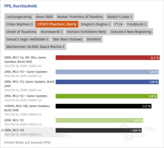

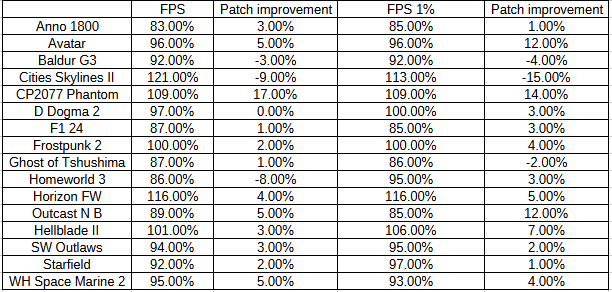

ComputerBase tested with Microcode 114 and all the other fixes:
Just +2% in average frame rates, the biggest improvement is CP2077 with +21%:
Screenshot 2024-12-21 at 11-52-46 Intel Arrow Lake mit MCU 114 & Windows-Updates im Test - Com...png
Arrow Lake is still 5% behind 14th gen in gaming.

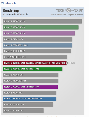

Possibly so, but at pretty low clock speeds, and on Zen 4 not Zen 5 (which should be the correct comparison at this time). Additionally, once you throw a MT app at it, Zen 5 gains around 40% performance per core while Skymont does not (lacks SMT). So I would argue that Zen 5c has considerably higher performance per clock than Skymont.
40% performance per core gain is just not true, not to mention the vast amount of workloads that do not benefit from SMT at all.
949->1208 = 27% not 40% and that's only in heavy multi-threaded workloads.
Besides hyperthreading is not a free lunch even in the heavy multi-threaded workloads that benefit from it the most. There are tons of issues with massive multithreading and consequently advantages that e-cores without hyperthreading introduce especially in data center.
Also if you did in fact want to add hyperthreading to Skymont it'd be less of a die size increase than you would think, maybe around 10-15 percent according to Intel's own figures comparing LIon cove with HT vs without.
In server loads, SMT has gained AMD 40% per pheonix reviews. For a desktop application, while 30% is certainly less than 40%, it is still considerable.
