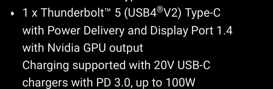

If people want more proof the “TB5” is watered down in the Razer, it’s TB5 port is only capable of DP1.4, not DP2.1.
So now it's Razer's fault, no longer Intel's?

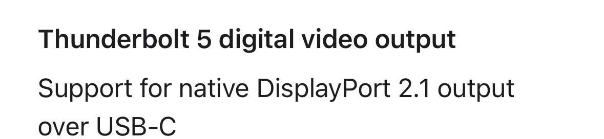

This is what proper TB5 specs should say:
MacBook Pro with M4 Pro
Razer blade 18 with a Ridge Barlow “TB5” controller:
Notice the difference in DP spec. Clearly the bandwidth is limited on the Razer.

DP2.1 means nothing since it's basically 3 different specs wearing the same hat.
I know, I trust Apple to include the 80Gbps 2.1 spec. Considering Apple’s TB5 cable is good and actually works with docks and monitors which a Maingear rep also backed up.
