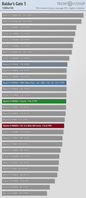

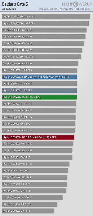

TPU compared 14900K at different TDPs and the average increase was only 78% and best case of 128% was in CP2077. Wow right?
Not really, because that was only HD resolution and 35W vs 253W TDP(7.2x), real power consumption was 16W vs 144W(9x)!
Performance difference between 125W vs 253W was not even 3% while consuming 38W more during gaming. :D Link

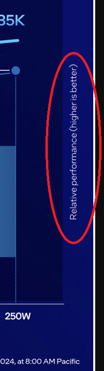

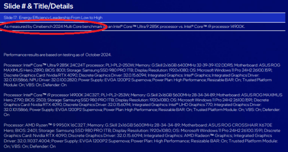

Here's a better slide for efficiency comparison (kind of as there are no hard numbers on the graph and it only shows Cinebench). Anyone have a similar chart for the 9950x and 14900k to compare relative curves?
Ah yes, here we go with the charts that if I handed in when I was an engineering student I would have ended up with a failing grade.
No description on the y-axis.
No idea of the applications tested.

If you though a bit about It then you would have realized that graph is a total nonsense or doesn't mean only the CPU but the whole system!
Not really, because that was 35W vs 253W! Difference between 125W vs 253W was not even 3%. :D Link
It is a poorly made chart, but not to the extent that you are mentioning.
(1) There is a y-axis description. Not a good description, but there is at least a description.
(2) There is a description of the application listed in that very same PDF file:
