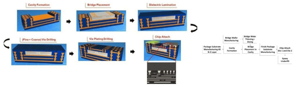

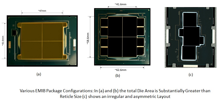

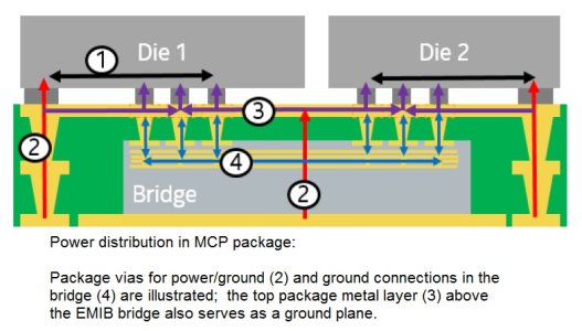

EMIB is different from Foveros they basically put a cavity in package than put the bridge/connectivity than some processing is done after that chip are placed on top of package connected by the bridge
Detailed read
Yeah it's the poverty option. Worse pitch, worse signaling power at a lot lower cost and no retsize limits.
Hitman928
Apr 15, 2012
6,695
12,370
Tech Report used to be a very reputable and big site and had lots of reviews and news. Unfortunate they died.
An interposer existed forever. Traditional CPUs dating wayy back used organic interposers. Like @Hitman928 says, it's basically silicon die on a PCB.
When they went chiplets/tiles though, they needed a much denser, faster interface. Since silicon is already in the nanoscale anyway, what they did is basically create another die just for communication, and that's what a silicon interposer is. The connections are in the micro scale, so it's pretty easy to make, and basic silicon wafer is dirt cheap when using for much older processes.
So basically they take that silicon interposer and embed in the CPU package. And you take your CPU die and put it on top of it, which is why they call it 2.5D. Now you have a super fast, dense connection for your chip(lets)!
The interposer isn’t embedded, it sits on top. Silicon bridges are embedded.
