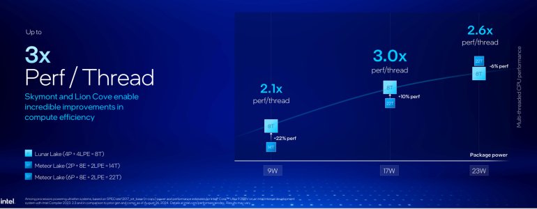

Intel Lunar Lake scaling in those intel slides is pretty flat after 17w. After all there is only 4 e-cores - p cores are only better than before - still awfully inefficient.

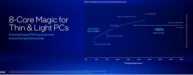

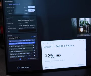

Are we expecting 288V to get close to M3 in MT?
It uses 30 watts as well in Cinebench R23. Intel's Skymont E-cores are more powerful than Apple's so it might.
No this is not expected I would say. The scaling from 17W to 30W was about 25% in Cinebench R23, I would expect a similar gain in CB R24 which makes it about 600 points at 30W unless the 479 score at 17W is way off but doesn't look that wrong to me. Sure other devices with a better cooling and lower temperatures might perform slightly better.

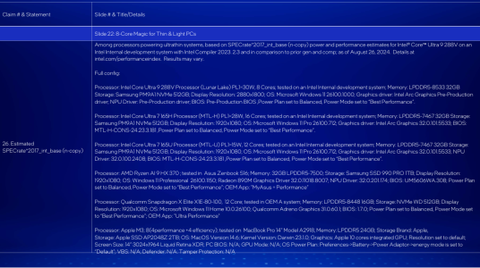

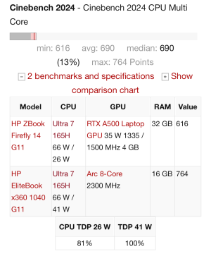

So if we go by these slides below, the 288V looks alright on multithreaded workloads. I’m sure that the data could be reverse engineered to get a decent approximation.
The HX 370 was in the Asus Zenbook S16 which gets 1008 points in CB24 and is shown the image below (based on computerbase data). Unfortunately, the 165H is on an Intel development device so we can’t really get a beat on what that performance level was.
Obviously the below image is giving some lower values. In fact the U7 155H seems to score a good bit better with similar wattages reported. So small sample size and probably bad cooling affect the results there.
But based on everything above, idk why a score over 700 isn’t possible. Considering they report only about a 6 percent lower score for the 288V at 23W compared to the U7 165H. Eyeballing it at 28W, looks like a 12% or so deficit to the 165H, and a similar 12ish% deficit to the HX 370 at 33W. Going by that, the score would be 880. It certainly doesn’t look more than a 20% deficit, which would put it below 800. And when considering the M3 in the MBP, which scores 714; clearly they’re saying that LNL can equal it at the same power level. And at 33W it looks like it’s halfway between 714 and 1008, or around 860.

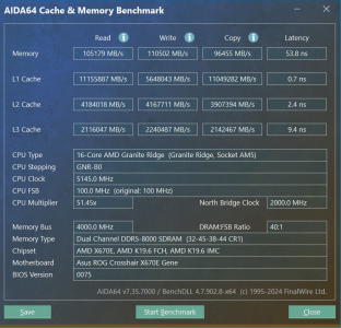

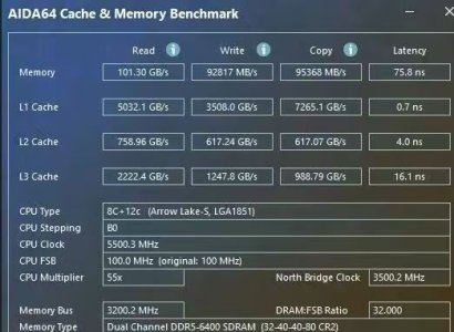

Aida64 Cache and Memory Benchmark Intel Core i7 265KF + DDR5 6400c32:
Latency looks a tad high, L2 bandwidth is a tad low, otherwise it's great.
And how Aida accounts for L0? Is it bundled with L1 or any other permutation?

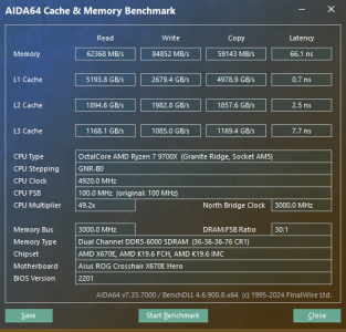

9700x/9900x for reference why do i feel like the soc is screwing memory latency a bit

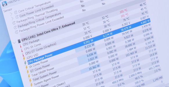

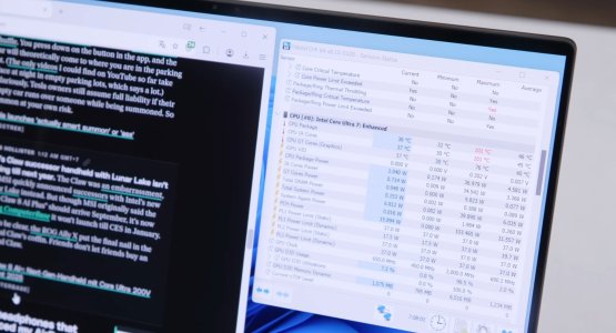

And some juicy Lunar Lake Intel Core i9 269V shots.
Idle power consumption, less than 0.2W, is something AMD should be envious of. My 7840HS "idles" at 3.5W.
Desktop AMD CPUs? 20-45W depending on your memory settings. 10-16W if you're running at JEDEC settings (which almost no one does).
Desktop AMD CPUs? 20-40W depending on your memory settings. 10-16W if you're running at JEDEC settings (which almost no one does).
They were not kidding idling at 0.17W - 0.5W is insane
I think something's up with your power plan or BIOS if your 7840 is idling that high! , even if it is a HS class.
6850U here idles around the 0.5 - 0.6W mark on balanced. (package power) possibly less when he screen's off , i'd have to check (which also may be why the LL there has a very low logged min)
9950X when tuned, lower latency is possible, even with the soc limitation
The cache latency on that 265KF seem alittle on the highside tho, maybe p&e core bug on aida (?)
I agree should be around 2-3W range but knowing windows :(
Is it the minimum or it can even below LNL has tiles as well it shows superiority of the packing tech they possess
mem latency is 10 ns worse than RPL. I thought it would be much worse than that based on MTL.

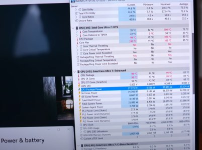

Josh128
Oct 14, 2022
1,320
1,990
Yeah those are very disappointing. On both ST and MT. My assumption was it was not plugged in. But still that MT score is awful, seems like it should easily be higher, I was expecting around 700-800.
ST is not disappointing at all here. @5GHz it is beating Strix @5.1 by 8-10%. Its beating the newest, fastest x86 core available by 10%, what more do you want? MT is nothing special, but if this is at 17W, its ~passable. Strix gets 954 @28W with 12 cores.
Still something not right. L2 are too slow. And for ARL everyone can use CUDIMM xmp 9200.
