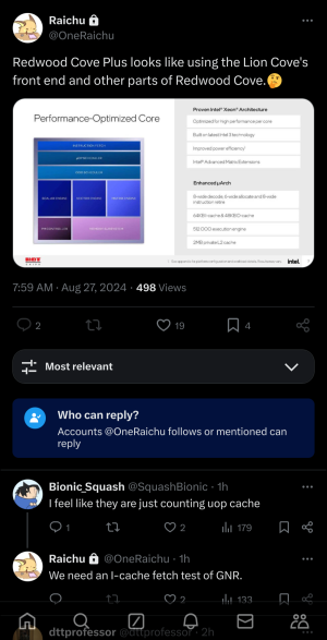

Granite rapids uses redwood cove plus which is 8 wide.. wonder how much ipc it gets vs lion cove

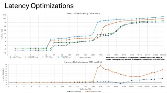

The cross core latency is interesting. The E core latency is similar to P core latency on MTL, and the P core latency is half of MTL. They say the low latency is one factor that enables the E cores to be used for multi-threaded workloads.
Can always refer back to what Pat said.
"10-plus percent on the core..."
So that alone will make it more competitive with Turin, since it's not client RWC.

So memory latency is still bad
Typical of laptops though. This is part of why Desktop version is 5% or so faster, not some fabric latency issue.
I thought it would improve in Lunar lake considering the on-package memory. Apple’s M4 latency is around 90ns which is significantly better than Lunar’s.
Is there any reason why?
Moving the memory on package itself won't lower latency. Otherwise, the lowest memory latency would be on Smartphones and Tablets. The lowest is on desktops, not Apple M4. On package memory is mostly about saving space. Actually Lunarlake talking about PHY power reduction shows even power savings won't be much unless some re-engineering is done.
While signal integrity will improve allowing it to potentially clock it higher, latency terms it's limited by DRAM architecture itself. The physical latency portion is an insignificant amount. HBM is even closer but latency is no better. It has loads of bandwidth though.
I know lowest is on desktop. I was more referring to the closest Lunar implementation outside Intel which is in tablets/laptops. It’s a big difference regarding the memory latency on M4 and Lunar. ~90ns vs ~128ns is quite big. Both LPDRR5.
Raptor mobile is around 110ns. Looks to be a design choice by Intel.
I've noticed some DRAM latency tests can be rather noisy, e.g., perhaps Intel's LNL test is not comparable with Geekerwan's M4 test?
Even within one test, it can be quite variable on the device / test. And maybe even run?
In AIDA64's DRAM latency test,
this i7-1250U + LPDDR5-5200 laptop hit 89 ns
this i7-1250U + LPDDR5-5200 laptop hit 146 ns (+64%)
No idea why. Timings appear similar enough, though one is downclocked temporarily, and the timings tightened commensurately. Unrelatedly, Qualcomm's Oryon DRAM latency is erroneously low (5ns to 10ns) in the same AIDA64 test.
What's a good real-world test of latency impact? Maybe better than synthetics.
You bring up a good point. With LNL, OEMs won't have a choice of LPDDR5X SKUs: everybody gets the same DRAM (I presume Intel won't be offering multiple latency SKUs per capacity option).

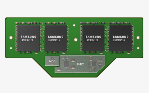

Somewhat unrelatedly, on-package LPDDR5 does use a different package size than soldered LPDDR5. I know little about this. Perhaps on-package DRAM SKUs get worse bins due to their lower volume?
Square-ish shape vs rectangle:
It is probably not an apples to apples comparison. Intel's result here is with 4KB page size; it includes address translation penalty spilling the TLB coverage.
Getting FHD screen instead of OLED higher resolution has another long-term advantage. The system will run cooler and the battery will last longer. Modern laptops get way too hot, which is a killer for batteries. My Yoga never gets more than warm, and it's completely passive. The fan doesn't bother me but a fan means it needs vents, meaning it gets dusty. HWInfo is saying after 7-8 years the degradation is only 10-15% for the battery which is excellent.
Interesting they are saying Intel 4 for the IO die on GNR-D. Probably a mistake.
According to One Raichu they mixed LNC front end with RWC+
It can't be due to lower volume as M3 Max has a square package. I think Lunar and M3 just have that shape due to space constraints.
You can't compare different latency tests, they aren't measuring the same thing. Gotta use the same software and testing methodology for both.
Not all software that purports to measure latency is accurately measuring it. Some older software may "defeat" prefetch with varying levels of success (for instance Apple Silicon's prefetch algorithm appears to be able to detect backward and larger step strides others do not) or does not understand the difference between x86's 4K pages and Apple's 16K pages as @quarph pointed out. Or even if you've accounted for that different CPUs have different TLB sizes and levels, but if you want to measure memory latency you don't want to add TLB (especially L2 TLB) latency to your figures.
So basically I'm not buying any comparison of Intel vs Apple latency measured in different ways. Heck even using the SAME software it can be tricky and you might think you've done it right then someone who knows some of the deep dark secrets of a platform like Hans DeVries or @name99 will point out something you weren't taking into account. Basically, there isn't a "true" result in measured in nanoseconds for a given platform any more than there's a "true" result of IPC measured in instructions per cycle. But you definitely can't claim two measurements done using different software by different people have any validity as a comparison whatsoever.

@511 It would be sad indeed if the 8-wide means it's from the uop cache like Bionic_Squash suggests. Truly the marketing team's garbage has infested both companies.
Yeah indeed i have mixed feelings regarding the 35% layoff from sales/marketing it is necessary but it's sad to see people getting laid off anyway we need someone to bench it but if it had IPC gains they would clearly mention it even if it was single digit like crestmont only time will tell
DavidC1
Dec 29, 2023
2,160
3,303
They are keeping it quiet for Granite Rapids but come back to the original comment by Pat again "10-plus percentage change in the core..."
Otherwise, the move from Intel 4 to Intel 3 would have been a year delay with a minor process bump, meaning nothing real gained. It could have been Intel 4 GNR instead of EMR so it would have been an overall loss.
However, if the statement is true, then the year delay would have made sense.

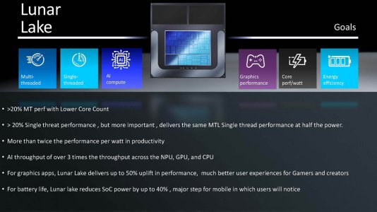

So is Intel sandbagging LNCs IPC after all? They are claiming >20% ST performance over MTL on one of their Hot Chips Slides. Since LNLs clocks stayed basically the same, LNC IPC must be much better than 14% or am I missing something?
