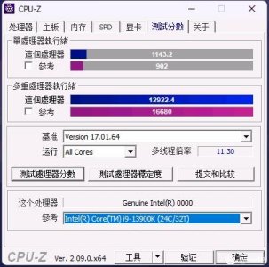

OMG!!! Is this even REAL??? or FAKE?
Thats a massive 27% single-core uplift. That too against RPL. Against MTL, it'll be well above 30%.
Assuming it's real, it's time for me say "I told you so" to around a dozen people here.
Hold on! @SiliconFly is typing...
I.ve already said desktop lion cove will be 25% or 30% plus over raptor cove.. in the forum they said its using 20A node 🤔

  • CPU-Z has never been considered a valid/good/decent benchmark.
  • Arrow Lake is at least Q4/2024, it's too early for such leaks. Intel last weak announced they had starting to tap out Lunar Lake CPUs.
  • Such a screenshot is too easy to photoshop. Don't get your hopes high. We've already seen fabricated Zen 5 screenshots from China.
GB6/GB5 ST results will show a much better picture. MT not so much.
Reactions: TESKATLIPOKA
It is a alright benchmark that at least scales compared to GB6. CPU-Z is a good indicator if compared against other Intel CPUs.
Chips and Cheese analyzed the bench and came to the conclusion that the instruction mix does not accurately resemble consumer workloads.
I call half BS on that, which bench really resembles consumer workloads SPEC - FP or INT, Cinebench, all the other crazy SIMD benches ?
I think the bench got overcriticized because AMD is slow in it, showing that the Zen4 core is less wide AND SLOWER, which it is.
I cannot make this sh... up, wait for GB6 benches and don't trust CPU-Z.....
The leaks seem possible, E-Cores are buffed beyond 50% and the P core are min +15% faster with additional news of the new layout.
Current System (13700K@1,34V 2P@5,8 6P@5,7 8P@5,5 8E@4,4 = CPU-Z : ST=938, MT= 13100), so quite realistic.
Reactions: Henry swagger

I am right, the bench showed nearly zero IPC gain (CPU-Z), the performance increase in CPU-Z was due to clocks. I think other benches on average showed 10% or 13% increase from Zen3 to Zen4 or is that wrong ?
And yet other benches showed IPC gains for Zen4. Have you ever considered the possibility that CPU-z benchmark is flawed?
Abwx
Apr 2, 2011
11,912
4,890
All conspiracy with no evidence. SKL is faster than Zen1 in all cases.
Lol, it s documented by CPU Z themselves, they explained the "reasons" for such a downgrade after they revised the 1.73 version wich was released in december 2016 and "updated" in may 2017 after they noticed the surprisingly good score of the 1800X.
