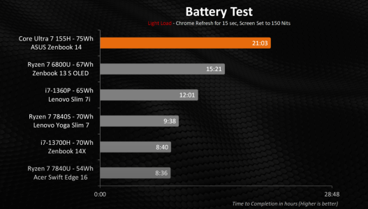

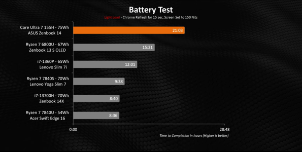

This is exactly what I mentioned a while back. This test shows MTL running with both the GPU & CPU tile off most of the time. And that makes one hell of a difference...
Beats AMD 7840 by more than 2X in power efficiency.
When doing nothing with the computer. . .
I mean, it's kind of cool to see it working, but no one will see a benefit like this under actual use case scenarios.

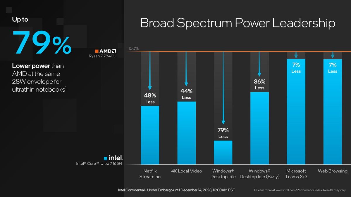

No one has a computer idle or in light load ever? You really think that?
I only know the experience of people that I see using computers. But they tend to be idle or low usage almost all the time. Typing a document, emailing, web-browsing, reading, playing music, cooking, conference calls, watching videos, etc. That is what I personally see most users doing most of the time.

It doesn't have >2x better efficiency than Phoenix per se. Just those tested PHX laptops are not that great in this regard. This is the problem with laptops in general, that they have big differences in power consumption under light loads despite comparable specs.
Here is ThinkPad T14s G4 with R7 7840U and 57Wh battery.Link
If I normalized It to 75Wh I would get ~17.5 hours.
MTL would still win, but not with that big of a margin.
That comparison was just refreshing Chrome every 15 seconds, which I'm not sure is equivalent to typing a document, emailing, conference calls, or watching videos. I suspect typing a Word document will fire up the compute tile.
Using a smartphone analogy, I personally see that comparison as something closer to standby battery life, which while useful is not something most users care about since screen-on-time is more important, and screen-on-time is more analogous to tasks that would fire up the compute tile (if this makes sense).

Indeed. Have to keep in mind that from the perspective of a computer, even 1 second of nothing happening is quite a bit of 'idle' time. I know my usual web browsing has plenty of longer pauses than that while reading through a page. And if normal basic interaction (scrolling, typing, etc) all stays on the low power e-cores as it should, then the periods between needing to make use of the primary compute cores can be quite a bit longer.
I think even while typing or even scrolling in a browser, the LP E cores should be able to handle it comfortably as the draw call isn't handled by the CPU tile.
Typing a word document and emailing shouldn't technically wake up the CPU tile. It's basically a bunch of draw calls. Conference calls might, but for how long I'm not sure. Watching videos is power consuming, even with the CPU tile off I think.
Then it s not connected to the internet, because the slightest activity will wake up the main cores, here they present a corner case where a same page is refreshed in Chrome, dunno if that could be called a normal usage, the ones you are talking about require the other cores to wake up...

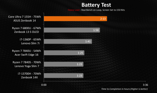

I agree with your point but it looks reasonable under load too. No it isn't able to compete with Apple but it at least dramatically improves on mobile RPL. I think MTL is alright but I wanted to see better PPW given the new node. The new iGPU is a very welcome improvement but I'm not too impressed with the performance of the CPU cores. Intel needs to replace RWC with something much better.
So basically in the heavy loading "test" the 7840U laptop consume 50W, wich is quite a lot for a U APU wich is suposed to go up to 30W, and the MTL laptop 35W, if that s not made up numbers dunno what it is...
And of course no idea of the quantity of work processed...
