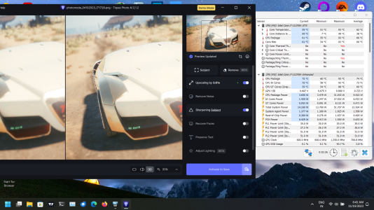

I ran Topaz Photo AI and PureRaw3 just to see what the igpu was drawing. About 12 watts for both of them. More than the GPU-Z stress test.
How much more compute does the A380 have over the igpu in my 13600K? Would be nice to speed this operations up a bit.
Do you use the A380 for gaming or compute?
Try Furmark or Furry Cube in CapsViewer, power consumption should be higher there. A380 has 5x the compute, 1 tflop vs 5 tflops.

With Topaz Photo AI:

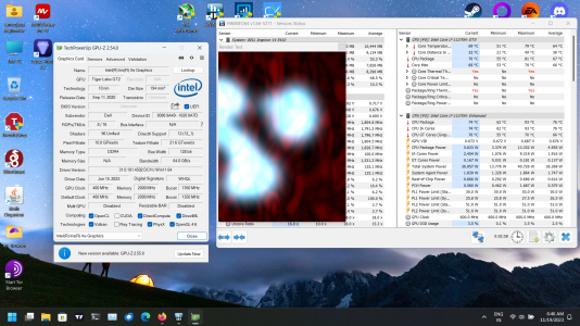

Running GPU-Z stress test:
After looking at these results I don't think the GPU-Z "stress test" is a stress test at all. Or I should say for a weak gpu like the igpu in my 13600K it's quite taxing as indicated by the power required. But your A380 is only loafing to run this routine as evidenced by the low clock and power usage. Your gpu is way down the v/f curve, mine way up. Interesting bench as it doesn't run "as fast as the gpu can run" it but the same for every gpu. It's not a race to the finish like most benches.
By stress test, I mean that it simply stresses the internal links between the iGPU and the rest of the chip. It is essentially running the data paths at full tilt. I agree that it doesn't stress anything in the traditional sense.
But your idle power consumption is way too high.
Hulk
5,205
3,838
Got it. But my idle power is zero?

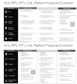

OK, WOAH!!! The thing that jumps out at me is real time raytracing! What the heck is that??? Does that mean zero cost raytracing in any scene????
Geddagod
Dec 28, 2021
1,588
1,654
40% scenario power reduction seems pretty interesting. Of course it's very vague, but if it's talking about CPU perf, that actually sounds not bad for a jump from Intel 4 to N3B, with a brand new arch.

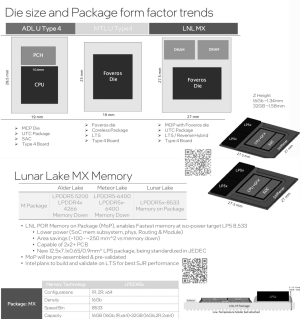

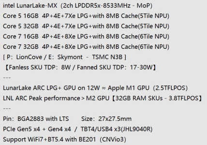

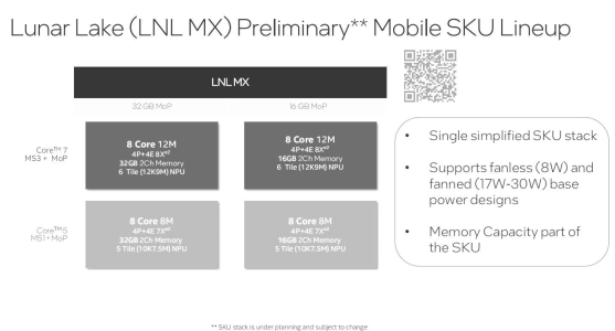

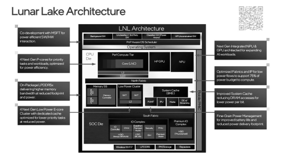

I am more interested on the last slide which mentioned 8 Xe LPG cores equal to 1024 ALU. And based on 3.8TF, we could estimate the iGPU clock speed to be around 1.85GHz...
FYI, M2's iGPU is having 3.6TF, slightly lower than LNL. We don't know the TF of M3 but should be slightly higher than M2; of course the real upgrade on M3 is hardware RT support. However, the real competitor is actually upcoming M4 from Apple cause Intel will most likely ship LNL in early 2025.
Well, at least Intel managed to have Apple's competitor after so many years of talking, let's not forget that LNL is based on N3B process, where is 18A's CPU that offer better PPA??? Still waiting:rolleyes:
