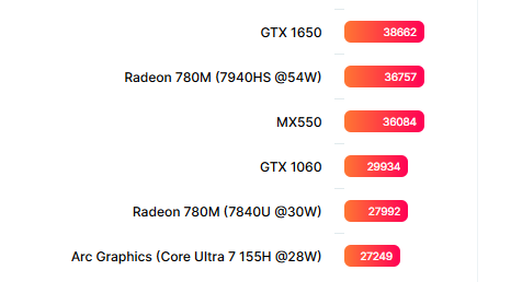

Anyways here's a benchmark:
Reactions: Tlh97 and gdansk
cebri1
Jun 13, 2019
373
405
I think this a pretty significant result for Intel. Matching the 780M on the first real iteration of a capable iGPU, considering the years of experience AMD has. Well done Intel.
