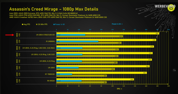

Problem with raising NGU, D2D, and ring to bring it up to “competitive” with the Raptor Lake is it ends up losing power efficiency to Raptor Lake. De8bauer had to go balls to the wall with Direct Die cooling and maxing out everything just to barely beat a stock 14900KS. The thing is the moment you tune load lines and undervolt a 14th gen processor, you can cut power consumption by a good 30-35% while gaining another ~20% in performance. Which means all that screwing around with Arrow Lake with expensive CUDIMM and overly-complex tuning was a waste of time, it's still 20% slower and uses significantly more power (when you add the additional power losses from DVLR).
28,173
19,208

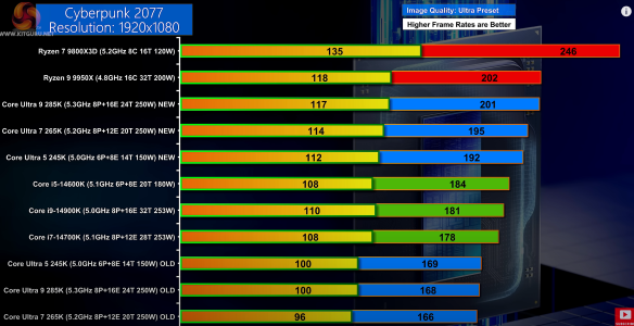

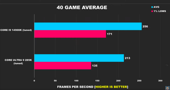

Yeah for productivity Raptor Lake can't compete with ARL because of the weak e-cores, that's not going to change at any time. Also Arrow Lake has an advantage of having less threads, as not a hole lot of software can even saturate 32 threads, so it can hit higher numbers in productivity benchmarks that are more thread limited. The microcode update from my understanding was mostly to fix gaming performance. The overall uplift was low, because the baseline uplift was mainly just making sure the balanced power profile in Windows matched the high performance profile. However some games got a huge uplift, like Cyberpunk 2077.
Cyberpunk is basically the best game Arrow Lake has to show off right now. This looks great on paper, until you realize you can tune both Arrow Lake and Raptor Lake. And if you tune both (even giving ARL the leg up with much faster and more expensive RAM), a 14900K still ends up being quite a bit faster a 285K, only trailing the 9800X3D by a few percentage points.
