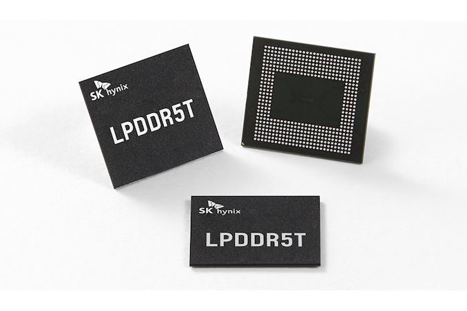

Supposedly it's going to stick to LPDDR5X, and not upgrade to LPDDR6.
Assuming you are correct that they stick with LPDDR5X, LPDDR5X-9600 is already available from Micron and SK hynix. That would give 12.5% more throughput. That isn't a lot more given the increased memory demands, but it would help.
Samsung is sampling LPDDR5X-9600 too: https://semiconductor.samsung.com/dram/lpddr/lpddr5x/k3kl5l50em-bgcv/ and they have announced LPDDR5X-10700 (25% more frequency than 8533 memory): https://www.anandtech.com/show/21354/samsung-unveils-world-s-fastest-lpddr5x-memory-10-7-gt-s

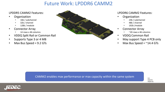

There is the possibility that Panther Lake will have a different memory configuration than Lunar Lake. If the iGPU portion is going to have 50% more Xe cores, and they will have more transistors in each one, and if the CPU portion is also expanded, it stands to reason that the package will grow. A larger processor package will give space for an additional memory chip, meaning that there is a possibility of having a 192 bit bus (3 x 64, 6 X 32 etc). That would better match the bandwidth needs of the expanded GPU and faster CPU.
Reactions: Orfosaurio
Panther Lake will use the 192-bit LPDDR6 CAMM2 memory (8x24 bit).
There's no option to use the old 128-bit interface (8x16-bit) because LPDDR6 has 24-bit channels:

PTL is too early for LPDDR6.

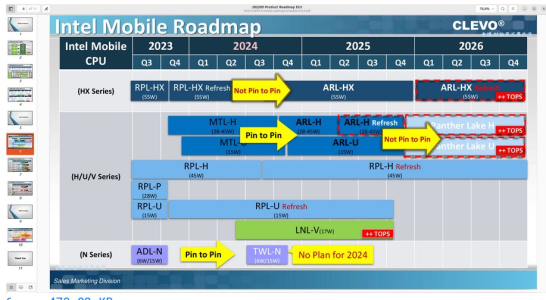

Panther Lake is a 2026 product that is not Pin-to-Pin compatible with Arrow Lake, according to the recent Clevo's leak:
I don't see any good reason to change the pin layout for Panther Lake and then change it again for the LPDDR6 support in the next platform a year later.
Intel will probably switch to LPDDR6 with Panther Lake and use the next 2027 mobile platform as a drop-in replacement. Many OEMs are used to Intel's two-year cycles (new platform -> drop-in refresh -> new platform)
I've seen this pattern in some other posts of yours, please stop presenting speculation as facts. Even if some of us understand you're only voicing your own (well informed) opinion and making an educated guess, other people on this forum and especially infrequent visitors will eventually mistake these for facts/leaks.
If we lack credible leaks or announcements to support a claim, we can always use certain types of phrasing to let others know speculation is involved. This is not a sign of weakness or uncertainty, it's a sign of respect for the rest of the community, and will probably avoid unnecessary additional discussions when folks dispute a claim.
I added a credible leak to support my claim ;)
Let's analyze that chart closely. Intel is going to update the pinout for PTL-U and PTL-H. This platform will be released in 2026 and actual devices will appear in Q1 or Q2 2026. The following platform released in 2027 will use the same pinout as Panther Lake.
Intel did that with CFL/TGL, ADL/RPL, MTL/ARL, and will continue with PTL and the next platform. It's too expensive for OEMs to redesign a platform every year.
DDR5/LPDDR5 is currently 4-5 years old and slowly reaching its limits. In 2026 and 2027, it will be completely obsolete, especially considering the AI hype. Those "++TOPS" we see on the chart require more memory bandwidth, so LNL is using one of the fastest LPDDR5 memory.
LPDDR6 is expected to be introduced this year. Rumors suggest that Snapdragon 4 Gen 4 and Apple A18 will use LPDDR6. I do not see any reason why it will not be available in 2026.
If we consider other aspects, the leaked chart tells us more information:
1. ARL can use the same SoC tile as Meteor Lake with DDR5/LPDDR5 memory. That's why there is no "++TOPS" label.
2. ARL Refresh will be more than a clock bump. Intel plans to redesign at least the SoC tile, add a more powerful NPU, and introduce the LPDDR6 support. That's why there's a note "Not Pin to Pin"
3. ARL-HX is the most confusing part here. For some reason, RPL-HX is not pin-to-pin compatible with ARL-HX. So, we will have a situation when the design should be updated for ARL-HX and once again for ARL-HX Refresh for the LPDDR6 CAMM2 support. It's not a big issue because the HX laptops are usually more expensive.
4. LNL will not have a direct successor. It will probably be replaced with the refreshed version of PTL-U, which has a new SoC tile and a larger NPU.
5. My biggest concern here is the ARL-H refresh. I'm not sure how Intel will manage this transition. Probably, the initial version of ARL-H will be offered as a drop-in replacement for the current MTL-H platforms (with the same NPU), but the vendors will be able to release refreshed ARL-H platforms a bit later. It still looks weird to me.
6. Technically, ARL refresh and Panther Lake can support both LPDDR5/LPDDR5X and LPDDR6, but I'm not entirely sure here.
