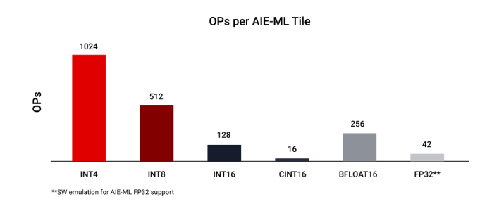

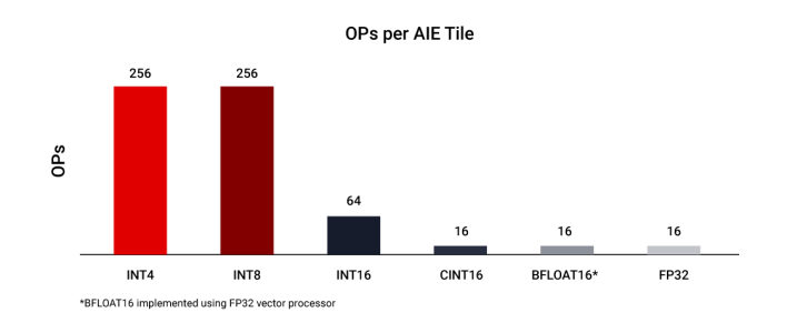

uzzi38
Oct 16, 2019
2,746
6,655
They can support different data types. But, they often do not. This link below is an Intel graphic, so it is obvious that it is geared to put Intel in the best light, but you can see that not all NPUs ran FP16 at the time of the image creation. If anyone can find AMD's list of supported NPU data types, then I'll link that as well (my Google skills are failing me, the latest information I found is that the list of supported data types has not yet been released).
It literally took me about 20 seconds to find these:
