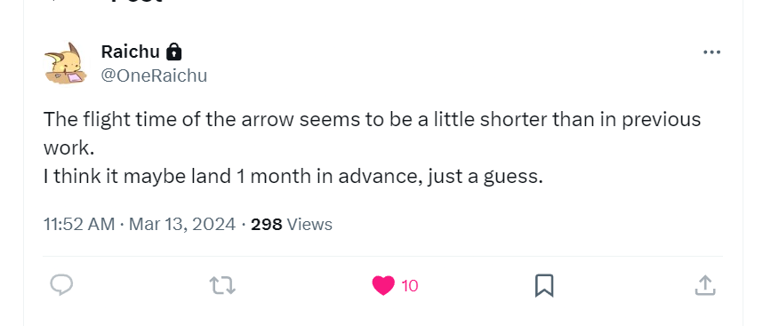

Cryptic comment from Raichu.

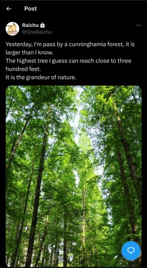

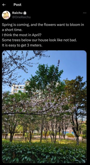

Also this one:1000006262.jpg
Pretty sure it's about Sierra Forest. He leaked Sierra Forest AP last summer in a cryptic Tweet about giant, nearly 300 feet tall trees. Nearly 300 feet meant nearly 300 Cores. The first part of this one from today is obvious, so we should expect SRF Launch in April (I think Intel Vision is in April). But what could the 3 meters mean?

Also this one:View attachment 95332
Whoosh :sweatsmile:
That went right over my head. I didn’t even think about it in the terms of a leak.

What if he simply likes trees?
I don't follow him but it's best to more clear than talking about blooming flowers if you know something.
This was his Leak for SRF-AP at the beginning of June 2023, more than 3 months before Pat showed it publicly:1000006263.jpg
I think @ashFTW is right, it might be 3GHz+. The Trees in the new pic from yesterday are nowhere near 3m, they are way higher.
If your post is about Sierra Forest, then it's logical to conclude that "arrow coming earlier than previous work by about a month" would indicate that Arrowlake comes about a month earlier than Raptorlake did.
If that's RPL-R then that's in October. If it's RPL it's in September. If it's Meteorlake then it's November.
This seems like a very good speculation as well.
"Easy" to get 3 and launching in April rather than the commonly expected June for H1 would indicate a product that would turn out better than expected(especially those that think E cores are literally mere step above trash).
With Zen 4's Integer lead being 20% over Gracemont, SRF with 10% more cores and 10% higher clocks would make it very competitive, especially in Cloud.
